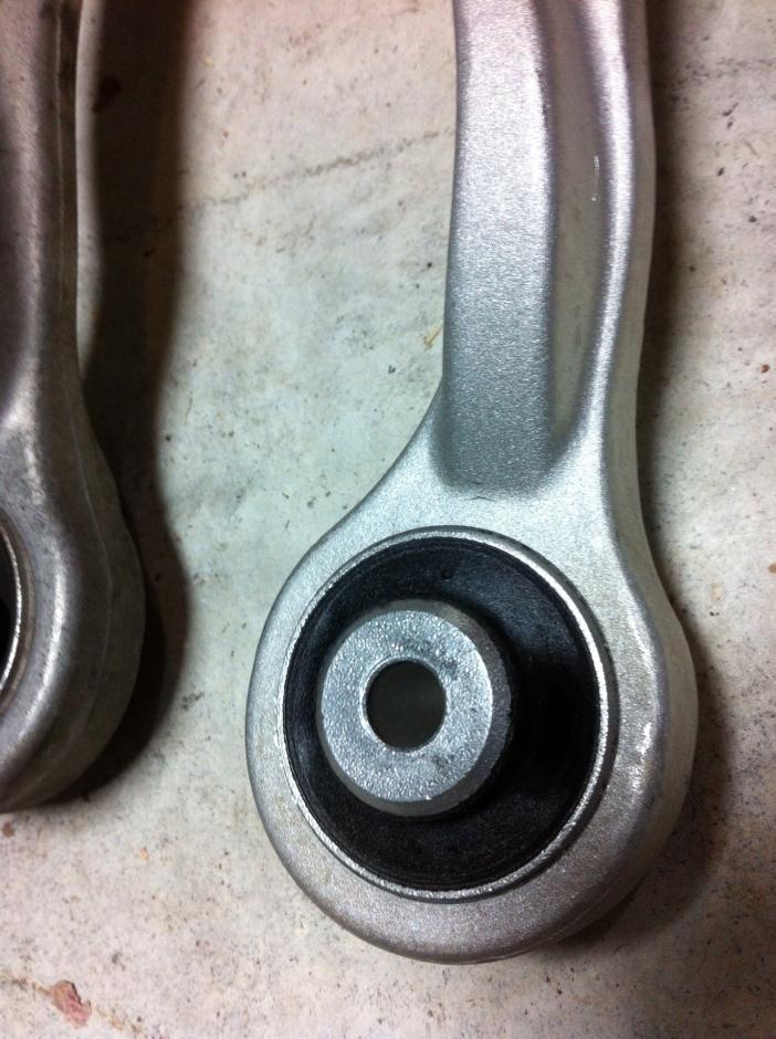

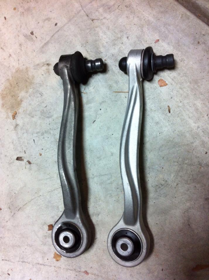

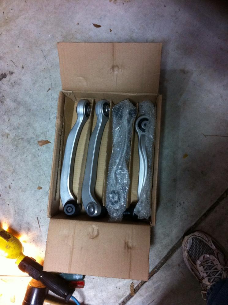

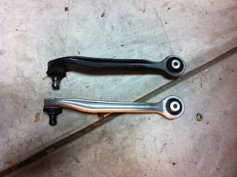

I installed the new upper control arms last week. Here are some pics of the new arms vs the OEMs I took off.
All the arms were shipped in bubble wrap. I removed it for pics.
The OEM is on top (it's black due to someone painting the wheel well.
Side-by-Side OEM is on left.
Close up of new arm bushing...it's looks the same as OEM.
Ball joint. OEM is on top.

They are holding up great...I have roughly 3k miles on them. No issues at all.
Those ones you linked to look very similar.
