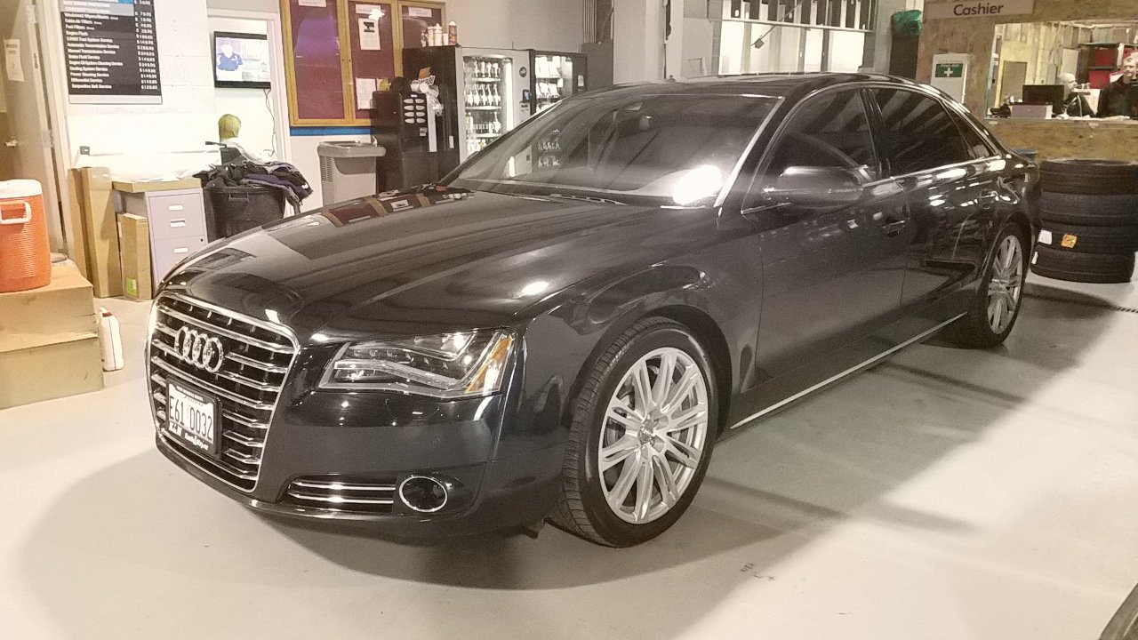

Hi dave944, I just heard back from them, evidently, when they replaced the wiring harness and the 2 coolant valves, the tech accidentally folded over one of the heater hoses. They found it and fixed it and now it has awesome heat. The only problem I have now is that they are stating it was a "previous repair" that caused it, as if they didn't create the problem. Well, no one was in the heater compartment but them and the heat did work perfectly before they got their hands on the car. Also, they mis-diagnosed it 3 times throwing expensive parts at it each time. They are stating that I now need to pay them for these parts ($1500) when the parts didn't fix the problem. Unfortunately I have a little fight on my hands with the dealership, but I have called Audi USA and they are going to bat for me. I will let you know once I get the car back how it turned out.
