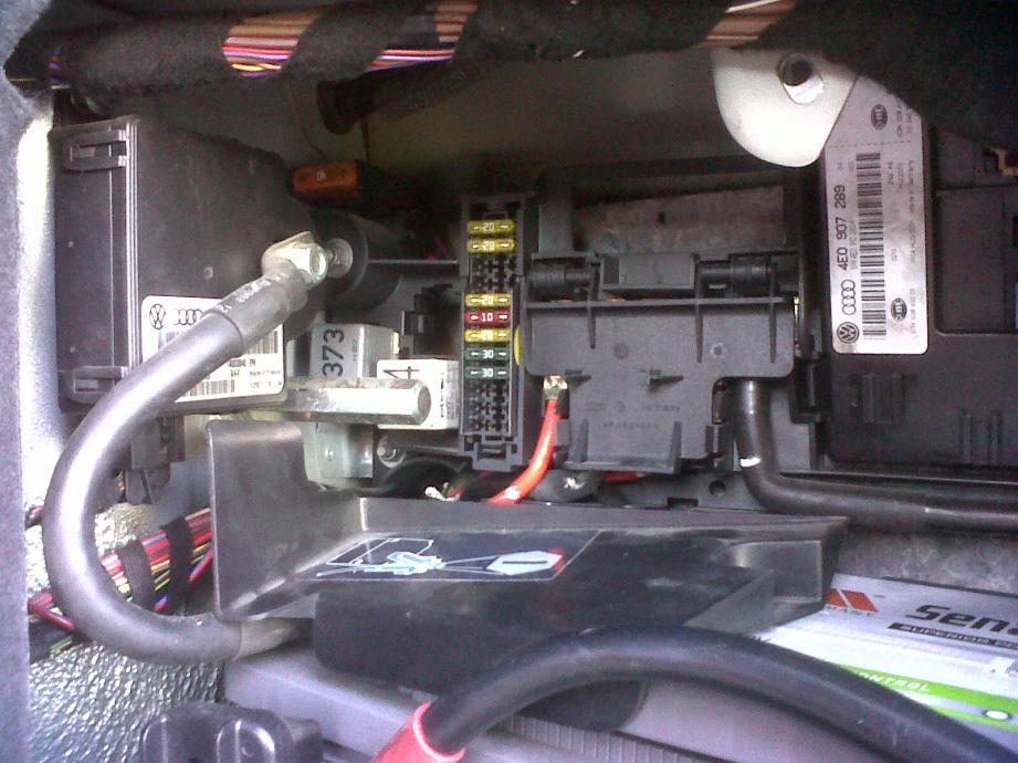

To avoid any misunderstanding, I want to specify that my boot is not self-opening/closing: Tha failure, after the complete discharge of the battery, is only the electric lock. Simultaneously to the electric boot lock, even the leds on the doors (indicating the alarm after the closure of the car), do not work anymore.
I think it is more an issue of MMI, but I do not know which unit manages the boot and the leds on the doors, or what channel to check.
I attach a picture of the fuse plate on the battery of my Audi A8 4E. I tried to remove all of these fuses for a few seconds... but no success.
Any other suggestion?
Thanks, Roberto.

Sorry about the confusion, mine is self closing . My boot lid won't close few weeks ago and i read the forum about the electric boot lock being unreliable and the only way to cure it is to replace the lock( the one underneath the boot lid) or try cleaning the lock by spraying WD 40 . I removed the lock cover (just by pulling it out ) and spray WD 40 into the lock especially into the gap between the lock and the boot lid this is to clean the contacts and pull the fuse out for a few seconds . Since then it's been working normal.
Hope this will help
