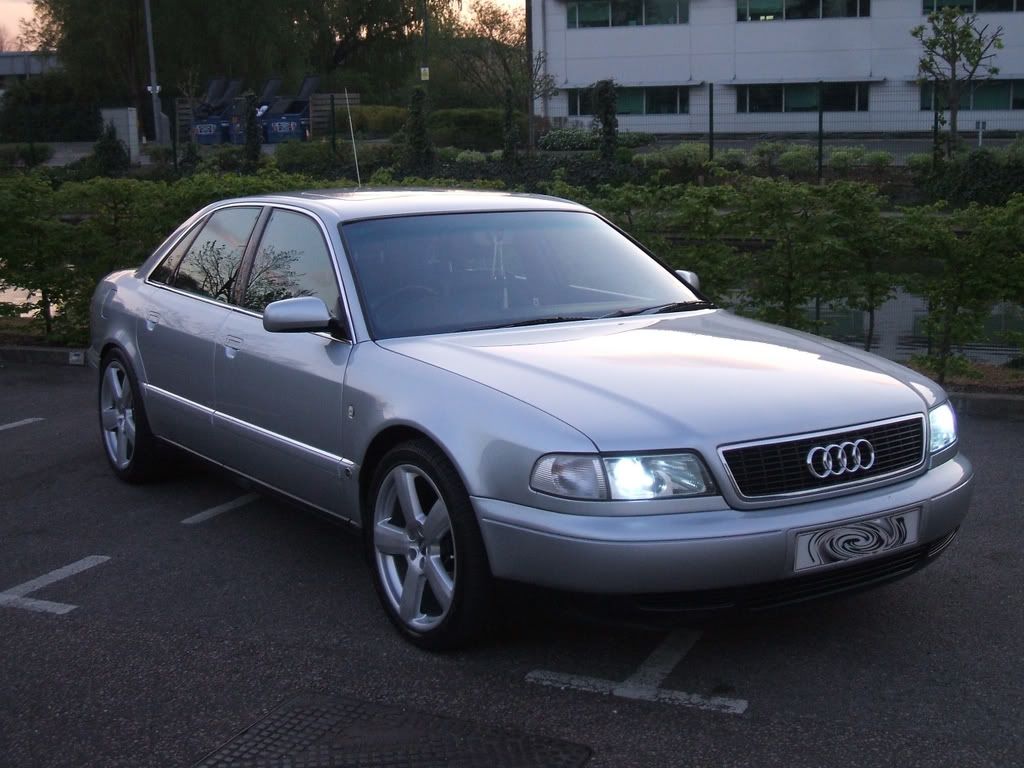

Dipped beam projector bulb size is H1. I cant recall seeing any D2 platform A8's without any projector lense?
also see here for fitment guide: http://www.powerbulbs.com/bulb_finder.asp
I'm running HID in mine no probs
