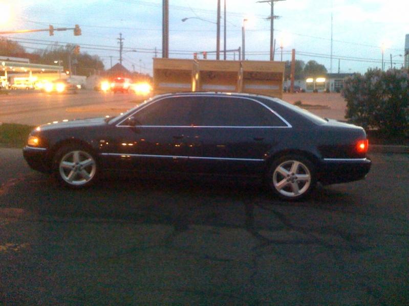

I have a ton of questions, and mild issues so here we go. First the mild issues. The car has 89000 miles on it.
The cruise control works funny. The only time it works is if I turn it on, slide the switch towards the off switch and then push the set button, and it works. The resume function does not work, and if I accelerate and release the gas pedal it does not pick up the previous speed.
Small leak: It seems like every other day I have a small puddle under the car. It is strange because by the end of a hot day the puddle has evaporated. I have taken it into the shop twice, and of course they could not find anything. Last night I put a pan under the car, and it looks like a small amount of Trans fluid. It is a pinkish red color. Could this be a simple gasket around the drain plug?
The rear sunshade does not go up. The motor runs, and it looks like a little black plastic arm pops out, but that is it.
Okay now the fun stuff. I have both an Ipod, and XM radio and I am thinking about the buying the USA Spec ipod integration system because it has an auxillary input. I figure I should be able to run the Ipod and XM radio through this. Does anyone know of any other Ipod integration device that will do this?
Well I think that is everything. As with any used car I know you have to always work out some bugs. But so far this is a great car. I get compliments everywhere I go in it. I have had a Lexus in the past but I chose to go Audi this time because of the Quattro system, and because there are less A8's out there. I thinks that alone gets the A8 more attention.

I guess you bought a girl car, sorry bout your luck.
