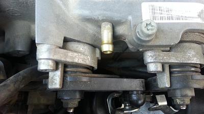

Hi,
Here is what I found :
photo 3 is a pic from google - it seams like the same engine (I am not 100% sure)
photos 1&2 - my engine. The red circled thing has a cap (removed in the photos)
I find interesting that on my engine there was a cap on this thing "opening" but on the other engine (pic 1) there is a tube leading somewhere...
I when to the dealer they said - "it is normal - the cap is suppose to be there, no tube in our database"
Some thoughts ?

Pretty sure my car has a hose on that nipple, so yours was capped off? I'm not sure what, but the previous owner might have bypassed something by capping it.
