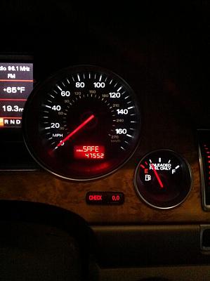

So the dealer had my car yesterday doing diag on the SAI. I get the car back and drive home...no issues. Get in this morning and start it up and the word "SAFE" appears in the trip odometer location. No button pressing can get rid of it. After driving to work and shutting the car off and then turning it back on, it's gone.
I've heard it could be an immobilizer/key issue? Anyone have any experience with this?
Attached Thumbnails "SAFE" in Trip Odometer...what does it mean?-photo-6-.jpg

Per the manual:
"If an unauthorized key is inserted into the ignition lock, SAFE will appear in the odometer display"
"You may not be able to start your vehicle if an ignition key of a different vehicle make is also located on your set of keys"
It probably lost it's sync with the key or there was something else on your keychain or in the area that it also saw.

Thanks...didn't even think to look at the manual.
Perhaps it's visit to the dealer yesterday confused the car
