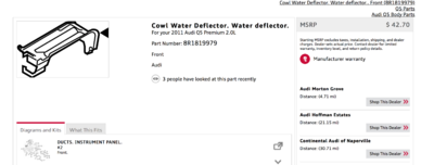

On the Q5, in the engine bay are a bunch of cowls, one on top of the other etc. It turns out, that there is a little cowl, called the cowl water deflector that covers the air intake grate and ducting that leads to the blower motor. That cowl was missing, which let in water; a little here, a little there. The water would drip down and collect in the bottom of the blower motor housing. Over time this water caused the metal to rust and eventually seize up. This process was helped by the last major down pour I drove in. So much water came in, that it flooded the blower motor and then found a path to the carpet. On the 2011 Q5, there is a foam thing that covers the space behind the glove box, and upon pulling on that a cup or two of water came rushing out. If you go to Audiparts, under the HVAC system, you can see the exploded diagram that shows the part that covers the intake. It was plain as day when I looked at it.I installed a new blower motor and will install the cowl and that should solve all my problems. So, If you are experiencing water coming into you Q5, I suggest you look to see if your cowling is missing.
