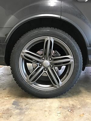

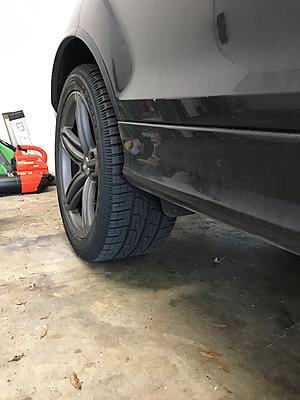

Also, I had friend who is part of large national tire wholesaler and he said/confirmed that the Conti new ExtremeContact DWS06 tires are really great product. I have not had extensive driving yet but as "new" tires both on aux streets and highway (I did test at up to 70mph) they road great. I will say the Pirelli P-Zero is perhaps slightly better ride but with them wearing out at ~15K miles, versus the DWS06 having 50K mile tread warranty, it was no brainer choice. Maybe other folks can afford $1300+ a year for tires but not me. Anyway, for those considering on size concerns and ride the DWS06s seem great ride and DO fit Q7.
I love the look and ride of the 295/40/21 Tires on the Q7. NoOriginally Posted by thekochs
I had worried about them "fitting"....ie, rubbing with the extra height. Rear wheel wells of course no concern. The issue/concern was the front wells as you turned in or out sharply, plus compression of struts/shocks. The installers checked (we had 35s on standby) and I was in garage when they installed and looked myself. They road tested.....and I did as well putting it thru forward and backward hard turns and up/down a VERY steep driveway...basically worst case scenarios......I found no issues. However, my caveat is that this is a MY2015 Q7 & it does not have the adjustable air ride feature. Thus, not sure for those other folks considering doing this that may have different MY/etc....but wanted to post this result.Also, I had friend who is part of large national tire wholesaler and he said/confirmed that the Conti new ExtremeContact DWS06 tires are really great product. I have not had extensive driving yet but as "new" tires both on aux streets and highway (I did test at up to 70mph) they road great. I will say the Pirelli P-Zero is perhaps slightly better ride but with them wearing out at ~15K miles, versus the DWS06 having 50K mile tread warranty, it was no brainer choice. Maybe other folks can afford $1300+ a year for tires but not me. Anyway, for those considering on size concerns and ride the DWS06s seem great ride and DO fit Q7.

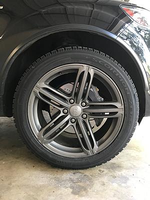

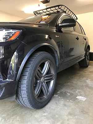

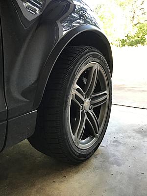

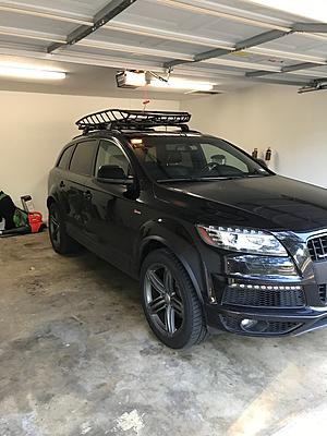

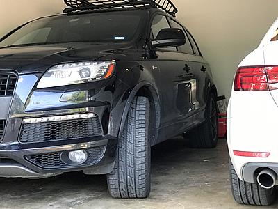

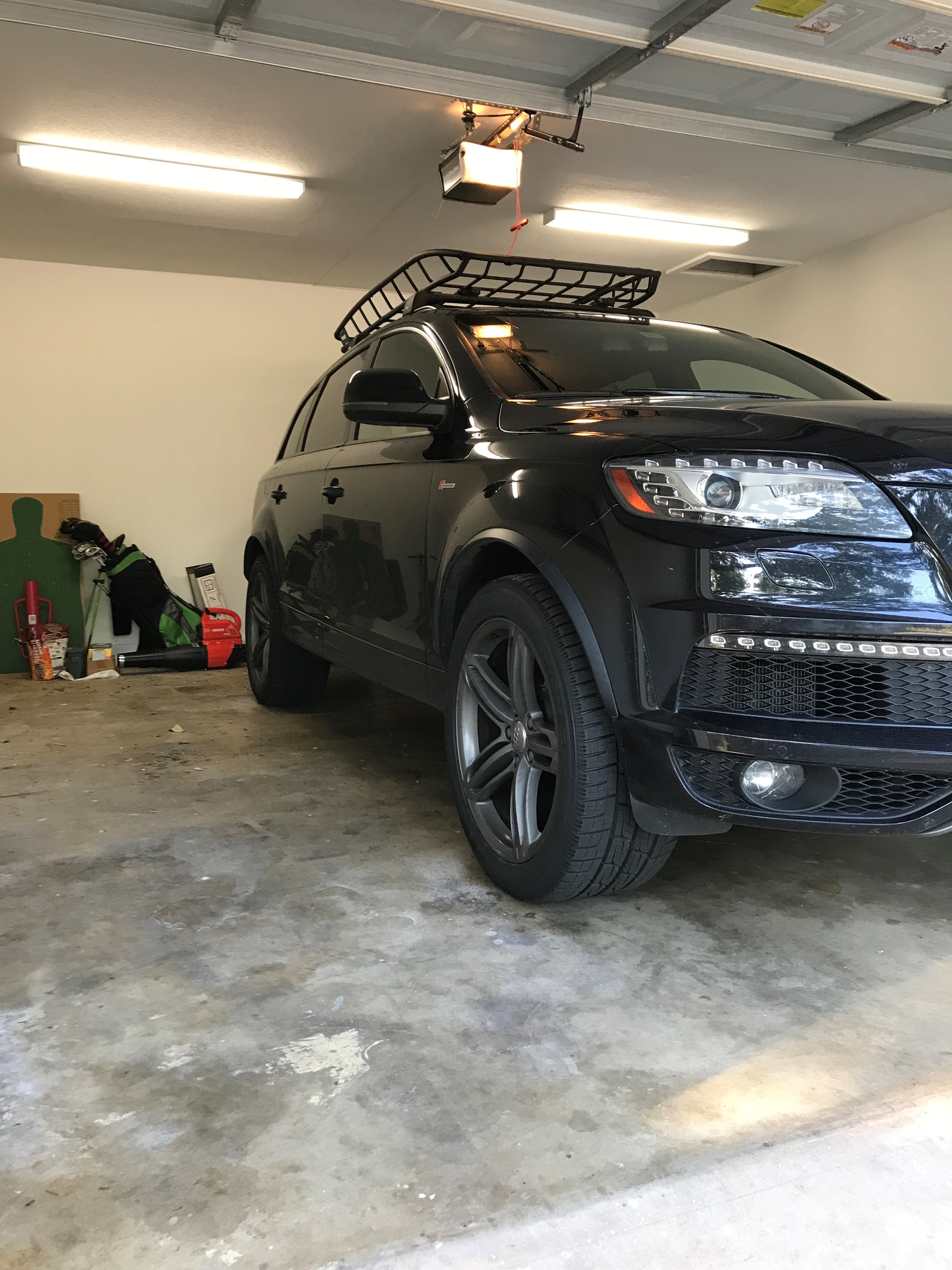

I finally put some new rubber on the Q. I went with a 295/40R21 as well but trying the Pirelli Scorpion Zero. Hope they work out well. I sure do like the way they ride! Virtually no difference in cornering or dynamic movements. I chose a more aggressive tire for improved off-roading capabilities as well.
