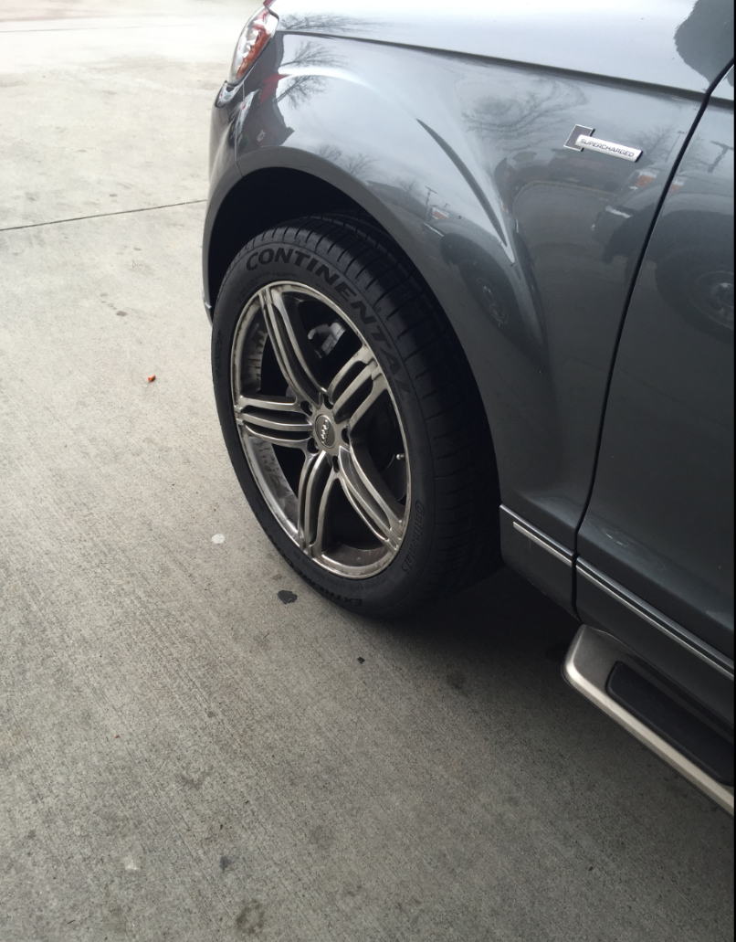

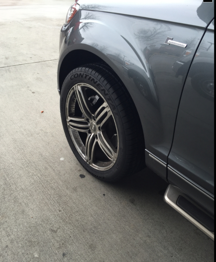

Got my 295 / 40 R21 Continetal ExtremeContact DWS06 on my 2015 Q7.
I put thru a lot of turning and up/down hill tests and is fine. No rubbing. Looks awesome !!! The Conti's have really nice ride. The 40s give a real meaty/beastie look over the 35s.
Attached Thumbnails Q7 2015 295/40/r21 ok ?-2016-02-09_181115.jpg

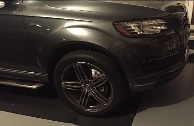

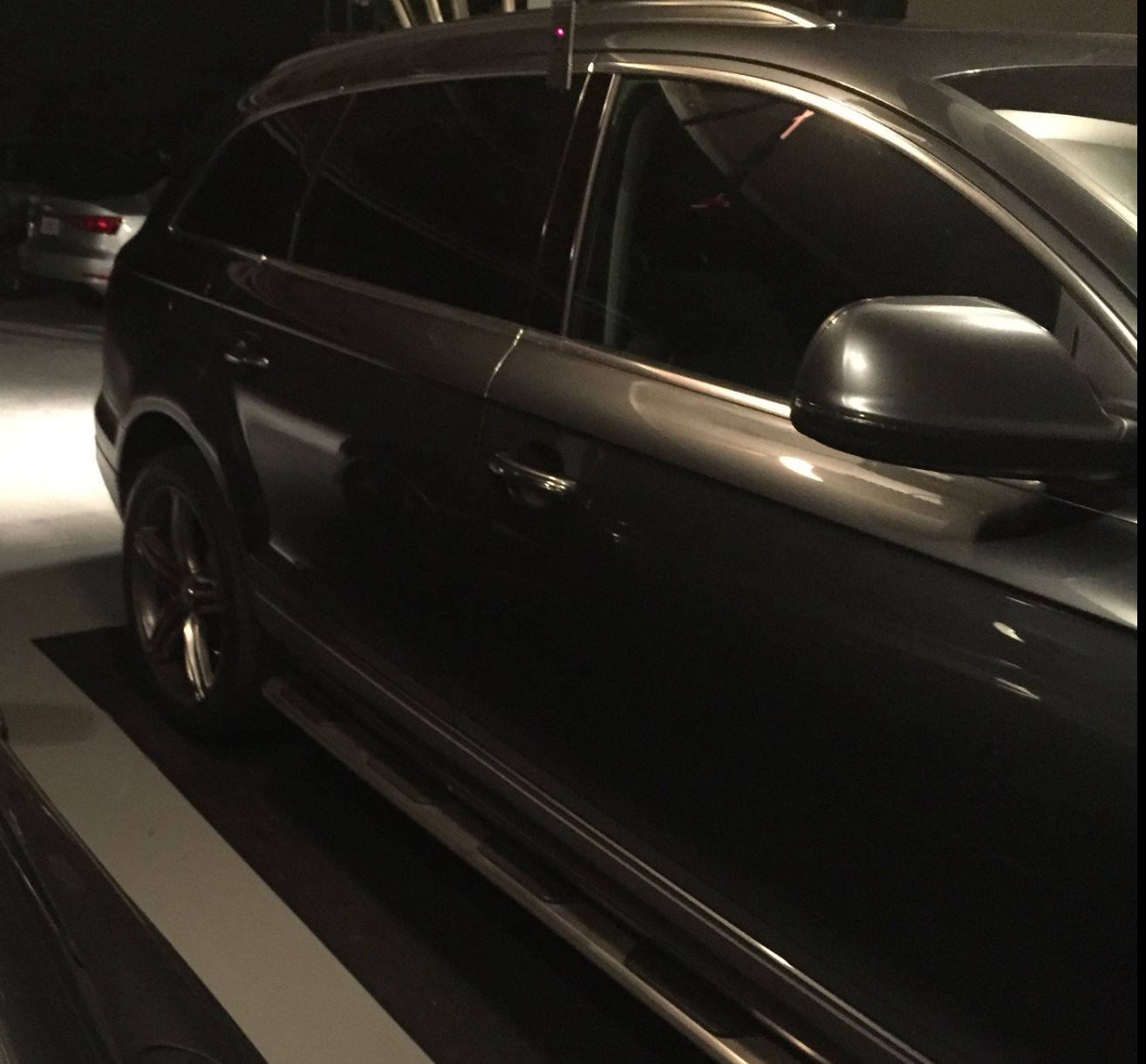

They look awesome....beefy, wide, nice looking tire....complements the car's lines well. I had to take in garage....at night now here. Hope this helps.
Continental ExtremeContact DWS06 295 / 40 R21
Attached Thumbnails Q7 2015 295/40/r21 ok ?-q7-1.jpg   Q7 2015 295/40/r21 ok ?-q7-2.jpg   Q7 2015 295/40/r21 ok ?-q7-3.jpg

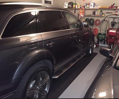

Here is the pic from thumbnail above......taken day I had them put on.
Wanted to post since that pic was during day time.
Attached Thumbnails Q7 2015 295/40/r21 ok ?-q7-4.jpg
