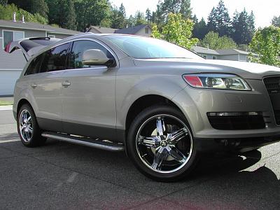

Q7 3.6 Premium: I just upgraded my factory 18's to custom 20" wheels. Ever since, I have a vibration in the steering wheel over 60 mph. I've had the tire shop re-balance wheels multiple times, and the last time, I even watched and saw that the wheels balanced properly on the machine. Still, the shaking continues. Anybody experience the same? How did you resolve the issue?
Attached Thumbnails Upgraded to 20" custom wheels; can't rid of shake-dscn1675.jpg
Last edited by haidangwa; Jun 6, 2009 at 09:22 PM. Reason: attached picture of the new wheels

wooo man those are nice...how much did those run you?
