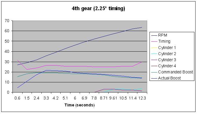

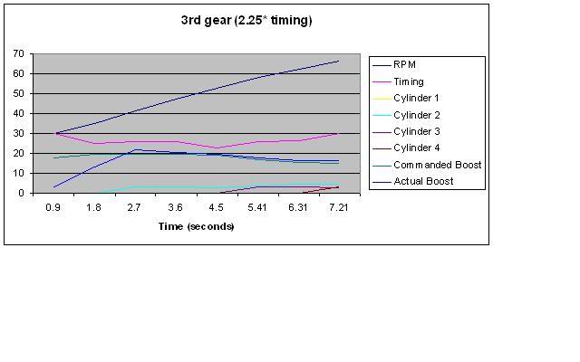

Even though it may have cost me an alternator... here's the results of some of the timing runs i did yesterday after advancing the timing to 2.25* adv from 1.5*
After increasing the pressure on the pump for the W/M, it eliminated alot of the timing pull I was getting before. Now at an increase timgin advance... I am getting actually less timing pull. If it weren't for the alternator issue, I would advance it further and run it again.
This is just two timing graphs from the two TIMING runs yesterday. I also did 3 dyno runs yesterday also. I have not graphed that yet though. We'll see here shortly
