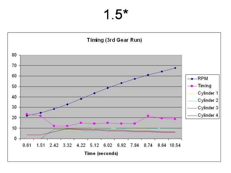

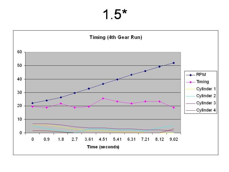

First off, let me apologize for how huge these graphs are. I copied and pasted them to powerpoint slides for my records and then saved them from powerpoint as JPEG files. I tried scaling them down but they lost a ton of resolution. Also, I logged channel 115 also (like the guy on vwvortex did to get commanded and real boost levels) but the numbers just weren't adding up right so I left them off the graphs
Vag-Com logs the boost in mBars (millibars) Basically, I exported the data to excel and graphed it from there.
Here's the boost issue:
ie data read boost at one timehack as 1860mBars in cell A1 on excel. In cell D2 I entered the formula
(=(A1/1000)*14.7) basically... mBars divided by 1,000 = data in Bars. data in bars multiplied by 14.7 (psi in 1 Bar) = data in PSI format. However, it was showing that I commanded everywhere from 18-38psi of boost and actually boosted between 11-33psi of boost. I figured this was wrong or I did the math wrong in excel so I left it out. anyhow....
Ok, Here ya go:

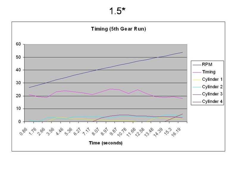

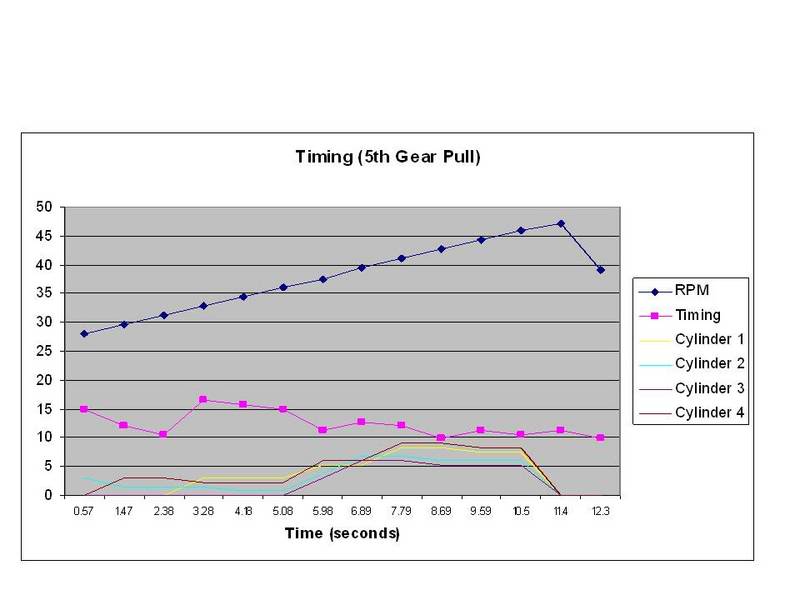

The first 3 graphs are with 1.5° Advanced Timing with Lemmingwinks (taken today)(3rd Gear, 4th gear, and 5th Gear)

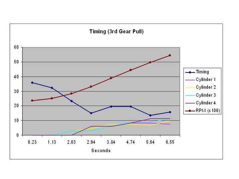

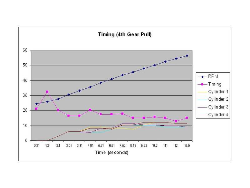

Next 3 graphs are with 3.0° advanced instead of 1.5° (Raken Last night)
Runs done in Same gearsName:  Slide1-1.jpg

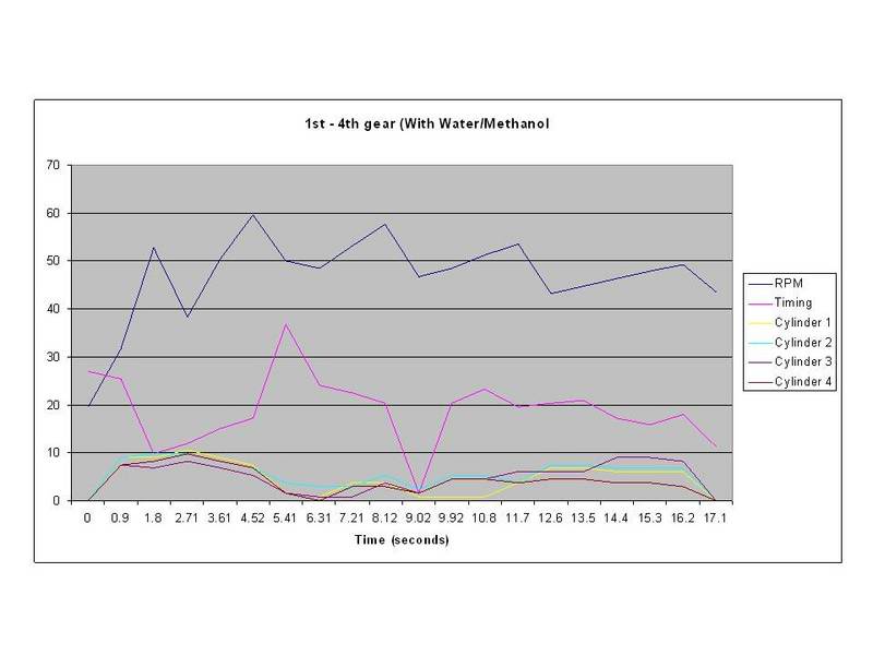

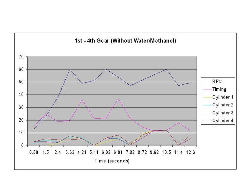

The last two are what I know Nate is looking for; 1st thru 4th gear runs with and without water / methanol injection turned on. **Note: I primed the W/M prior to running with it... and turned it off a mile before logging without it. Here ya go:
Old Oct 23, 2007 | 11:46 AM
  #60
cincyTT's Avatar
I'm make believe
Joined: Dec 2006
Posts: 17,587
From: In my head
Default RE: Post-W/M Lemmingwinks Tuning Progress...
If you are seeing above 20* of timing, that is already alot. Your still getting pull, so you may want to try to pull timing until the CF goes to 0 and see what the overall timing goes to.
