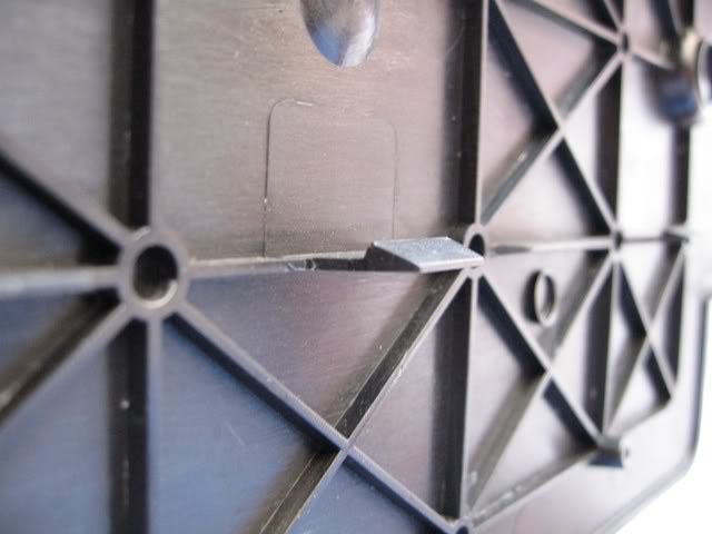

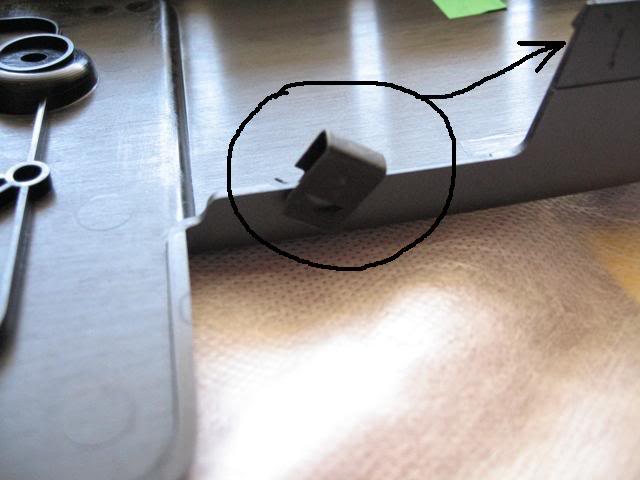

Take off the clips that are located underneath the bottom of the panel. There are two of them, one on each side. Here is a front view of where they are located underneath…(you can feel them with your finger and if you have a flashlight you can see them very easily.
(the hook is located to the right on the snapping piece. I just put it there so you can see what it looked liked, but the arrow points to where it really is):

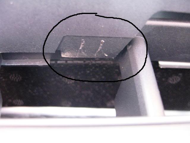

STEP 4: Unsnap the bottom part where you took the hooks off of.
(you can see the scratches that get left by the hooks. They have little prongs on them that grip to the car and the license panel. No one will ever see them since it is under the car, so don’t stress about it)

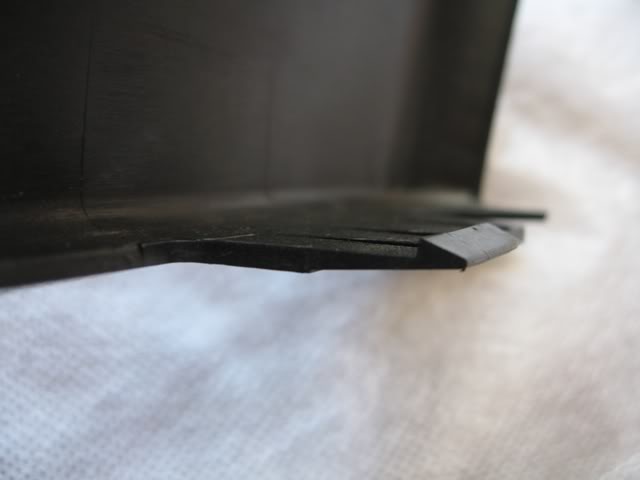

This is where I was nervous, but you have to do it carefully and slow. I would start by sticking your finger at the top of the panel thru the grill and pull off the top part on the left or right side (do it on both sides). Let me tell you it is a pain in the butt and if you have big fingers is could be tough. This will loosen it up on the bottom and then the top but not in the middle (this is the tough part). Here is a picture of what I mean. There are little hooks that snap it into place and it works out easy if you pull somewhat in an upward diagonal motion; hence the reasons why you want to loosen the top part after you loosen the bottom part.
(here is a picture of the bottom right snap…see the lip, you have to pull that lip part down and pull it toward you).
(There are three snaps in the center where the license plate goes. The middle one is the toughest, but give it a little muscle and you will get it off).
(Here is a close-up of the center snap. See how there is a lip to it also…that is why I tell you to pull up at an angle, it came off easier that way.)

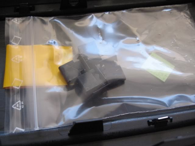

STEP 8: Put the clips back on. It gives you five of them but you be the judge, I only put two of them back on.
