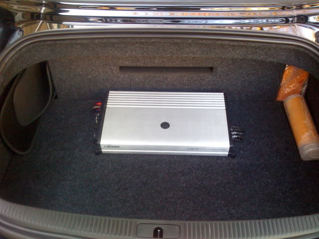

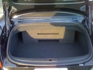

Hi Blindperspective, I can't say I have had any experience with the bose ....but when I purchased my 08 TTr I knew while on the highway with he top down I was going to need some serious upgrading also. My fix ..I have the nav and ipod also so I had a custom box made to fit under where the top sits with a 13" slimline JL bass speaker and changed out all of the oem internal speakers and tweeters with Diamond speakers and added a 1000 watt amp that bypasses the amp already in the car and that is tied to a rockford fossgate 3sixty one signal processor to help them all play nicely together. I kept my head unit because I wanted to remain oem. The trunk itself act as a giant bass box (the speaker faces down and the hole in the side is a port) and If I sell the car the amp and box can be removed. I have to say I was quite pleased with the sound.
