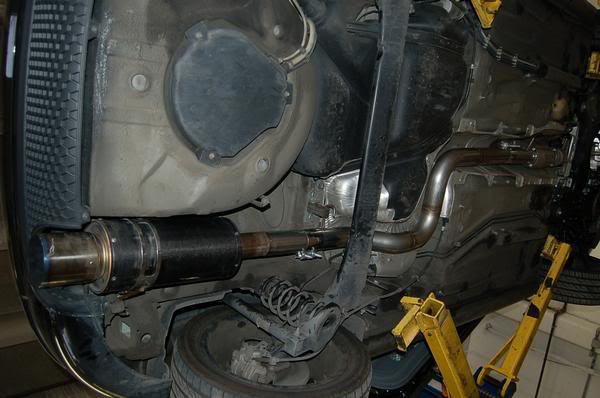

Here is a pic of my custom 3" catback on my FWD TT. You will probably end up with some vibrations, especially if you go BT, but they will mainly be from the DP. It is easy to make the catback not hit the rear subframe.

how bad are the vibrations from a DP? if i have any issues, im not likely to keep a DP.
Old Nov 12, 2008 | 08:09 PM
zero388's Avatar
Joined: Jul 2007
Posts: 249
they are not that bad at all only really noticeable at idle, the vibrations I am experiencing is partly because I have the kinetic exhaust manifold which moves the DP a little bit. but I doubt you will have the issues I have because you have a 225Q and I have a fwd.
