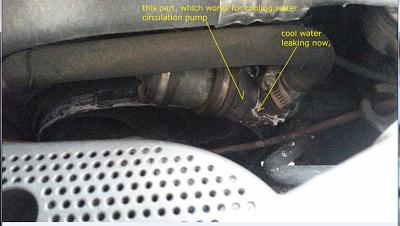

Old Jul 4, 2014 | 06:41 AM
zinkim's Avatar
Joined: Jul 2014
location of the 2ndary water pump, refer to my photo attached.
My tt also leaking water at the pump.
