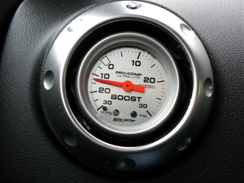

I used the mount that came with the gauge. Just had to pry the fins out of the vent.
If you do this carefully everything can be put back together at a later date.
The only other thing I had to do was cut a little notch in the air duct, so the vac line wouldn't get crimped. Something like this... /\
