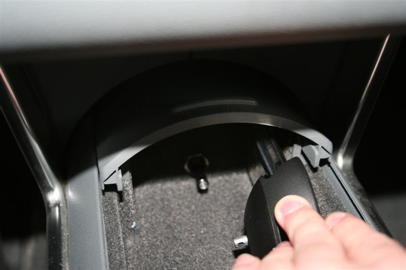

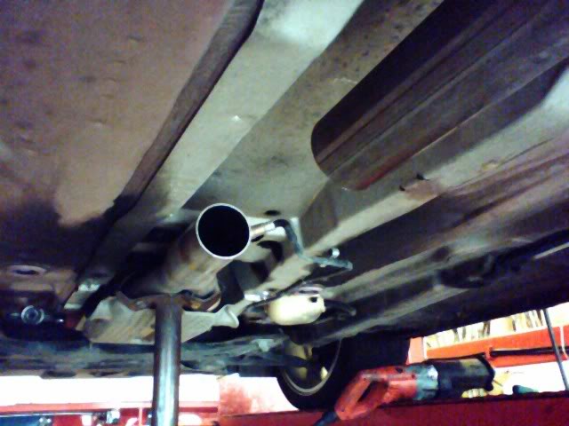

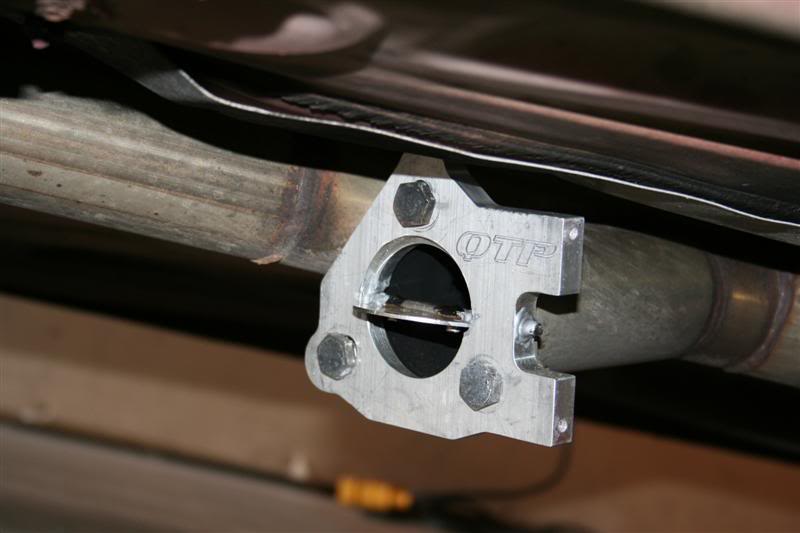

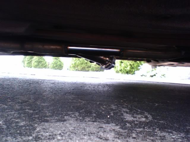

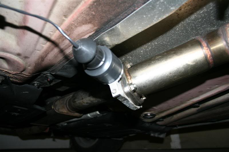

Hey guys, just thought I'd chime in quick. My 225Q TT is pretty much stock, except for the usual chip/intake/dv. However, I've had an electronic exhaust cutout (2.5") for a while now so I figured I'd let you guys know how it is.
First of all, there isn't much room under the car the work with, so the cutout had to hang down a little bit... I'm also on coilovers, so I do scrape it. I barely ever do, only on steep driveways and any speedbump [8D]
With the dump closed, I do not notice any performance loss due to "added backpressure" if it really is an obstruction. But even if I did, when I want max results I will open it.
With the dump open, yes turbo lag is reduced a little bit and spool time is quicker. However, I DO NOT BOOST MORE. I might make a little more boost in a higher gear (because you obviously can't hold 20psi in every gear, you start to lose some as you switch gears) but I never spike higher or anything like that. I have a boost gauge and even in first or second gear, I spike at 22-23psi every time whether the dump is open or closed.
