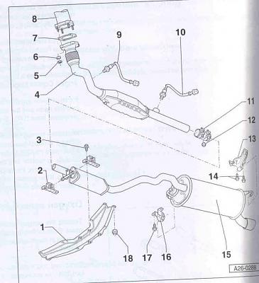

Here is a picture from my Bentley manual, this is for a 1.8T non quattro. You didn't say what you had. Part #9 is what you're looking for.

I have an 02 225 quattro coupe. Its an AMU. Do you have a picture for that?
Old Feb 17, 2010 | 09:45 AM
carhopper's Avatar
Joined: Apr 2007
Posts: 221
It's roughly the same place, right after the turbo. In fact, it's even easier to reach. Just get a good O2 wrench and some long extensions. You're looking for #2 in this diagram.
