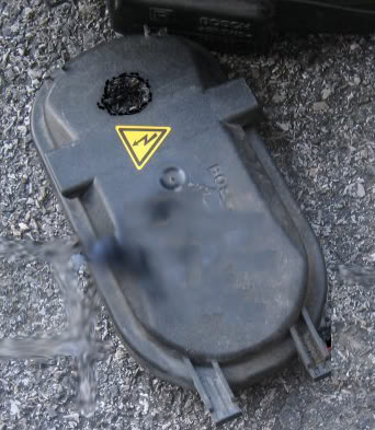

2. Once you remove the headlights, remove black plastic cover from headlight.

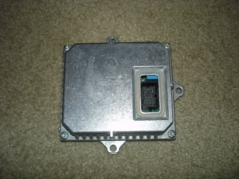

3. Remove Ballast, and unplug wire harness from ballast, there are 3 Phillips screws holding this
in.(The piece you will be removing is shown before.)

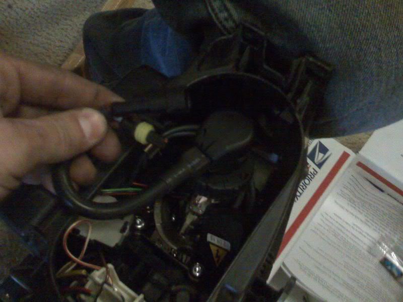

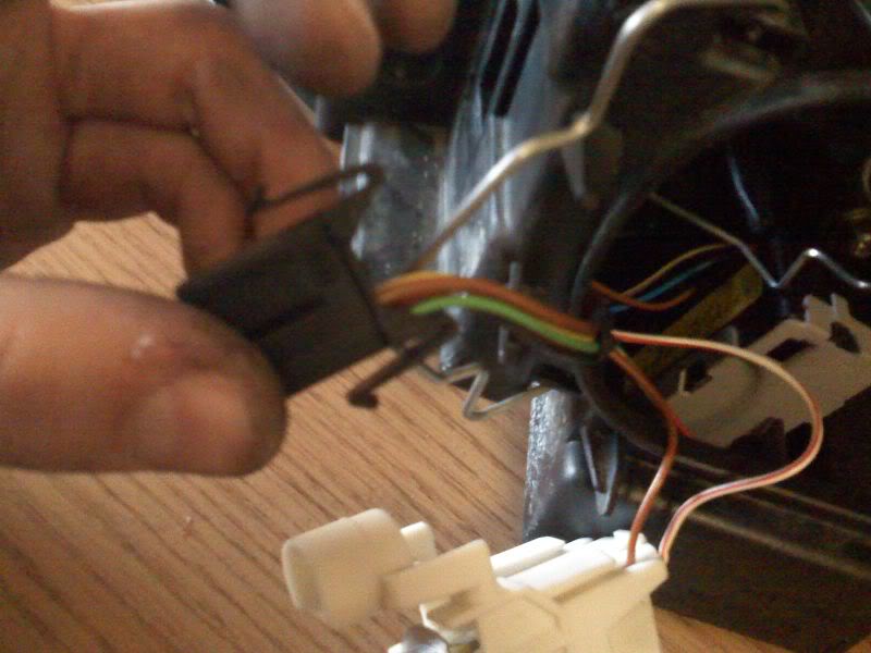

4. Push the tabs on the top and bottom of the plug to force through hole, and play with the plug until you can get it to come out through the back opening where the cover was previously. You will need to remove High Beam Bulb and holder, its still a tight fit. (The plug shown below is the plug needed to be pushed through.)

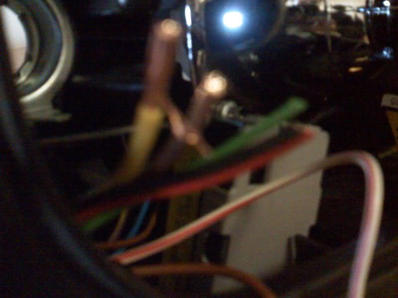

5. Cut off connector from Ballast, you only need the Yellow and the Brown Wire, the green
black and red are the wires that went to the original igniter. (This is the step some of you may not like, I cut mine with an inch left on the plug side, so you can always solder the plug back on if you ever have to, you can see the yellow and brown you need stripped below.)
6. Take the back cover and drill a one-inch hole about an inch in from the opposite end of where you have the two tabs.(Sorry forgot to take a picture, so I photoshopped this one)

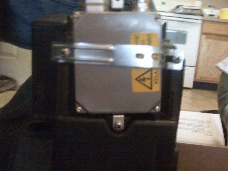

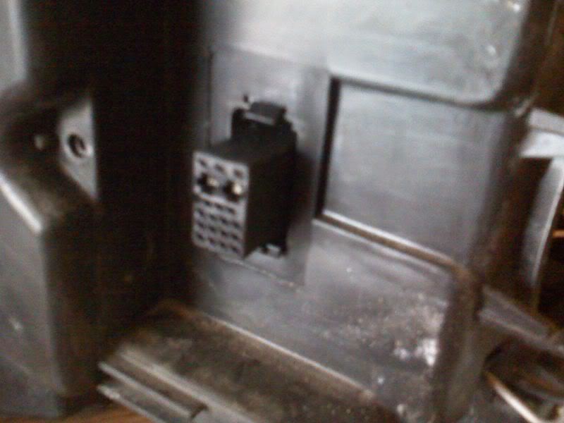

7. Mount ballast in original location with wires pointing back. Make sure to use the double-sided tape to cover up where the hole is from the oem wiring harness. You can use one of the brackets that were provided with the kit to bend and mount similar to how it’s pictured below.

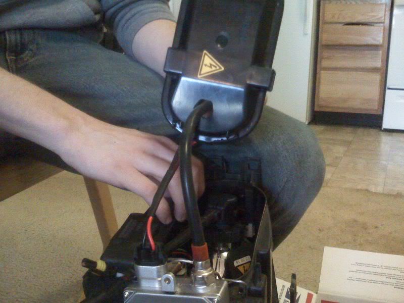

8. Now feed the wires from the ballast through the hole you drilled in the back cover.

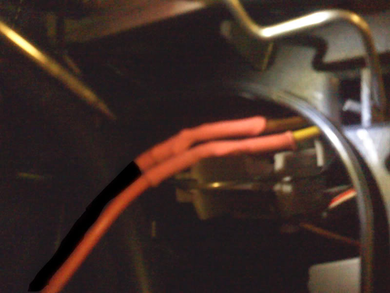

10. Strip your yellow and Brown oem wiring, and strip the black and red from your kit. Shrink wrap and solder Black to brown and yellow to red.

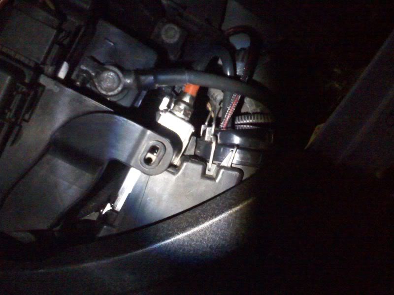

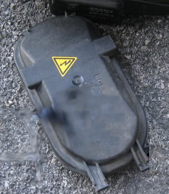

11. Connect amp connectors to the amp connectors on the wire coming from the bulb. You will be connecting the wires that have a plug coming from the ballast and then the one with similar plugs coming from the wires on the bulb. (You will be connecting the connectors below with the ones that are from the ballast.
12. Make sure everything fits up nice with the cover back on. Lock the cover with the metal clip.
