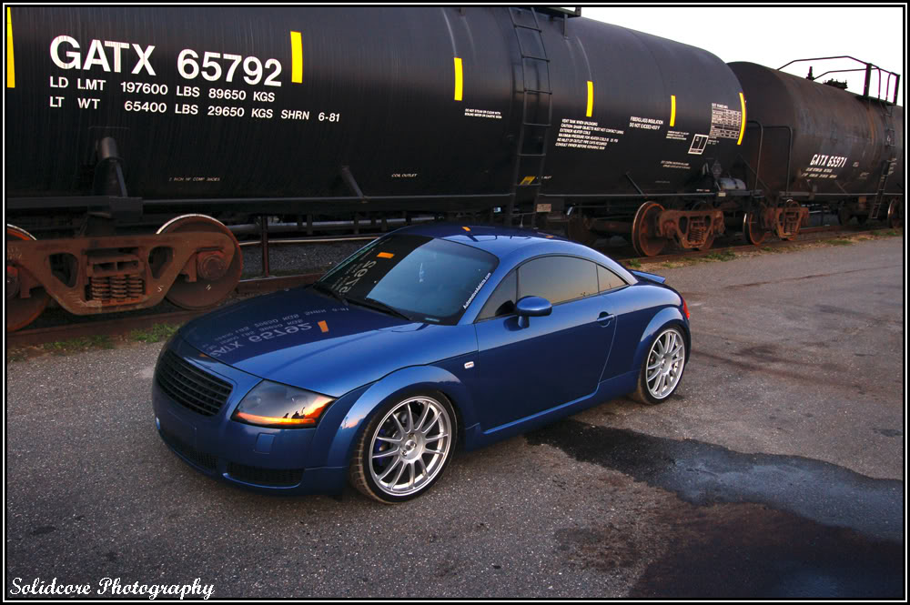

well this guy has a lil tuck...the rears seem a lil high to me but seems like a good set up.
welp, looks good none the less. i know TiTyman (audizine/vortex) has vmaxx's (which is his only susp. mod) and his setup is pretty slammed. i guess i'm goin w/o the rear perch. i want them bitches to tuck!

From: Over There
Default RE: Got vmaxxed!
that blue tt is HOT!
Old Apr 22, 2008 | 08:26 AM
  #24
theTTkid's Avatar
Joined: Mar 2007
Posts: 6,349
From: Everywhere
yea it is!... its real clean
