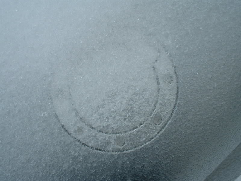

Be prepared for this...
I've found it more frustrating to be at the gas station, and not be able to fuel up!
Even with the ice removed, the bastage of a gas flap likes to freeze shut. A hairdryer or flathead screw driver work well to get it open.
