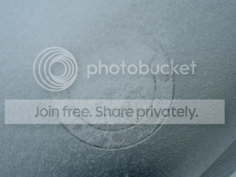

Be prepared for this...
I've found it more frustrating to be at the gas station, and not be able to fuel up!
Even with the ice removed, the bastage of a gas flap likes to freeze shut. A hairdryer or flathead screw driver work well to get it open.
haha same thing happened to me last week with the gas cap, had to get out and scrape it off really well to get it to pop open =)
