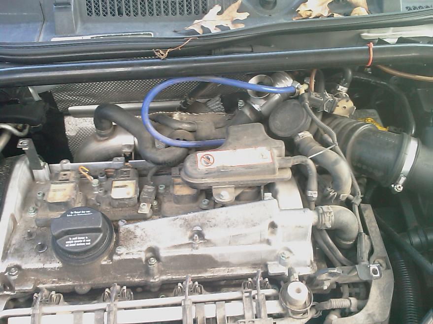

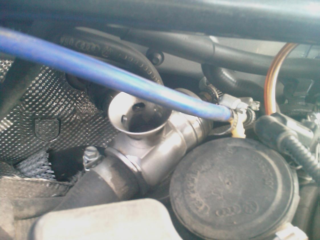

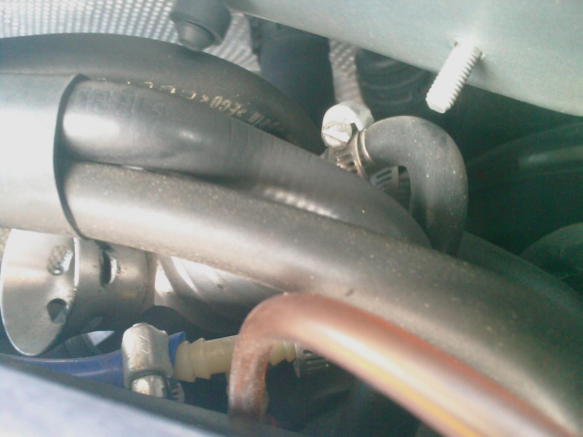

Ok here it is... It's different from the picture offered.
Ideas?

Looks like a GFB hybrid. Just make sure that bov part on top is closed and not venting air when the car is idling. Also that blue hose it long as hell and it doesnt need to be. But the thing that concerns me is, is there a clamp on the bottom side of that bov that connects it to the intake?

It says GFB on the top and it also says 1000 3-5....
Yes there is a clamp and what am I closing? I see a brass(looking) connection on the passengers side of the valve that screws in and out. How would this cause my psi to die off at 15 sometimes but other times his 20+ and hold?
