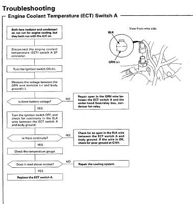

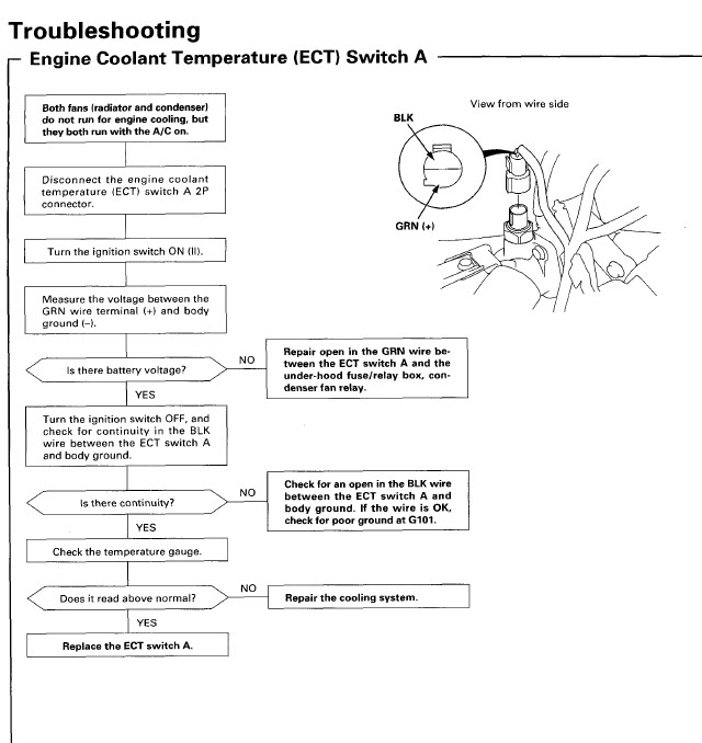

attached is what i used for my honda in which i replaced the ECT switch... is the same troubleshooting accurate for an audi?

. Quick and easy way to test this is to disconnect the radiator control sensor harness and touch 2 and 3 together I'm referring to the connectors inside the actual harness...link them with some wiring if your fan goes well good for you!! then its not your fan and you just have to replace your radiator control sensor. Of course it could also be your radiator fan module. But yeah try it out.The manual does state that the fans can come on at any time; my Honda does the same thing in where it turns on the fan after the engine is off. You may be on to something though in that it could be a fault of some sort if the fans aren't intended to come on at all after the engine is off.
