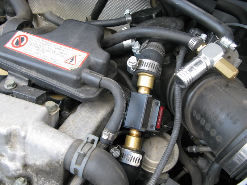

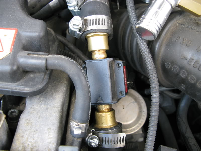

Since all my pics died with the new forum layout. I dont have any atm. My setup is basically:
air compressor filter
1/4" double male fitting (x2)
1/4 female with 3/8" male fitting (x2)
1/2" hose
90* brass fitting to replace the regulator.

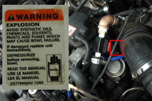

So, after 3 trips to home depot, not realizing I only have about 5-1/2" to work with, I finally got it right after becca posted those pics. So, thanks!!!
Next time someone asks you: "Do you want me to draw you a picture?" Just say yes... it might actually help. I found something interesting though with the warning sticker on the filter. I peeled it off (it was hot!) and stuck it on a white piece of paper so it's easier to read. The picture is self explanatory.

It is true what they say then, a picture paints a 1000 words.

Okay, I have a question. On the pictures above. ouTTie914 is not using a 90 degree brass elbow but HawaiiTT is. Is that a different set up or is someone missing something?
