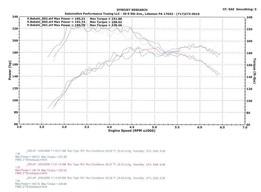

Before Pullies: 196.5 whp, 233.8 wtq Average over 3 runs
After Pullies: 192.6 whp, 230 wtq Average over 3 runs
So......looks like I lost an average of 3.1 whp and 3.8 wtq with the pullies. The ambient was 2 degrees hotter on the 2nd day but that's not much. And all dynos were done at APTuning on the same dyno, and pullies were professionally installed.
I don't want to recommend or bash this product, I am merely posting my dyno's so people thinking about buying them can make objective decisions. I, however, would interpret the data as indicating that neuspeed's pullies are worthless. Sure, 1.8T dynos aren't super consistent but a 3 hp and 4 tq loss really is hard to swallow when I should be gaining hp. Oh well, live and learn.
That is all.
