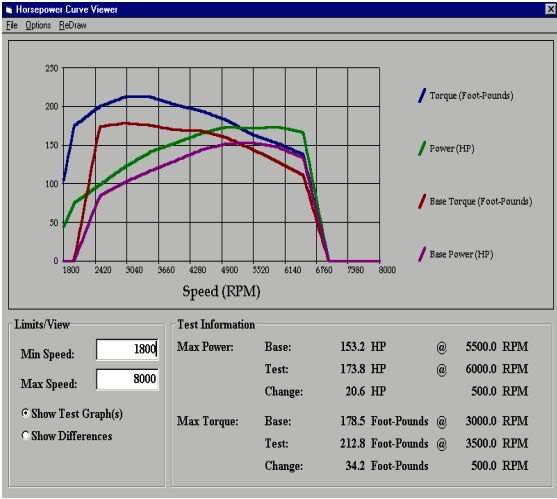

Here's a dyno from GIAC's website for 2002-2000 180 TT. I'm going to assume this graph is for FWD, my TT is quattro.
Note that the max torque they record is 212 ft/lbs.
My boost gauge maxed out at 15 PSI. I'm not sure what boost I was hitting when 235 ft/lbs was hit, but I can guarantee it was not over 15 PSI.
