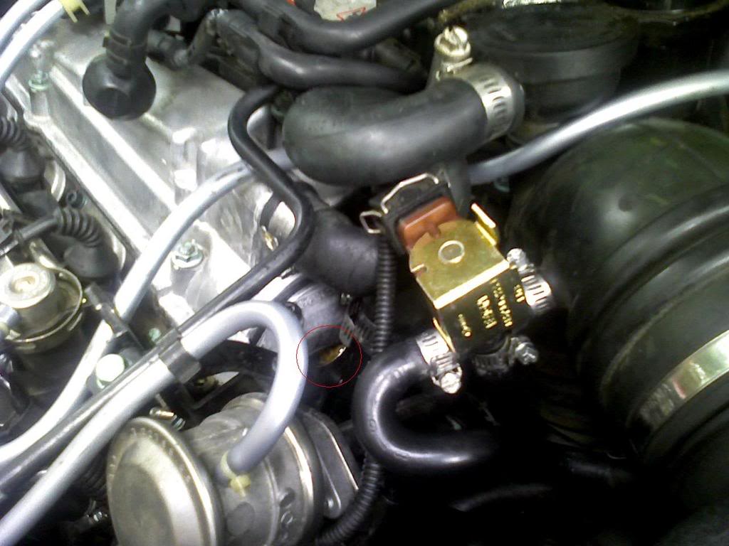

I was just out there this morning... I will post some pics later, but I think I found a big one on some gastket where the valve cover turns up into a curve. Hard to describe, but it was doing some major bubbling there. There's also a semicircle hole missing out of the block right where the leak is. It all seems like a really bizarre design.

something like this blue peice?
Its part of the valve cover and if its missing, you have a HUGE leak. Replace the valve cover gasket and cam tensioner gasket.

Holy ****, I bet that's it. Where is this blue piece supposed to go? Here's a pic of the place i'm talking about. I've highlighted the semicircle with a red circle:

thats the little blue halfmoon gasket in that pic...MAKE SURE you get blue one!!!! i became a pro at the valve cover install etc because the dealer gave me a white one....also to replace that metal gasket as seen in that pic use this little trick.....get a torx socket(cant remember the size) and loosen one of the cam chain tensioner screws and press down on the cam chain tensioner to make room to slide that gasket in and out....trust me it works i did it twice using this method.....this is a very expensive job for the dealer because they take all that crap apart....but a tech on this site i think told me this trick....also i used a valve cover gasket sealer and NO leaks whatsoever...any questions let me know....its prolly a two hour job the first time around....i can do it in about 30-40 mins now...lol
