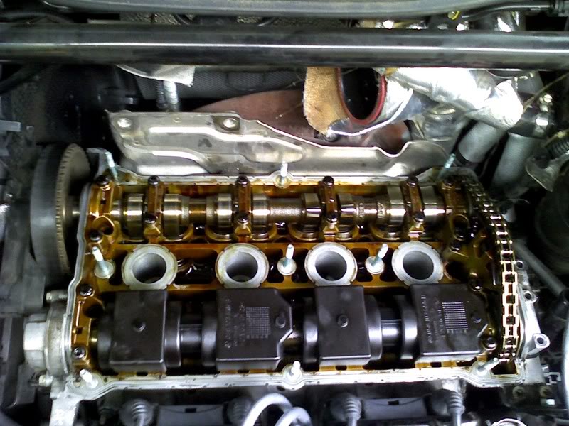

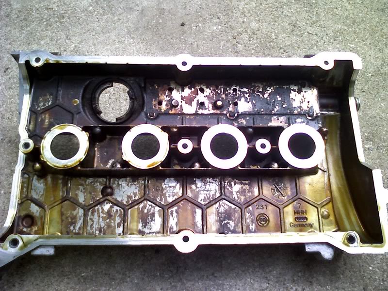

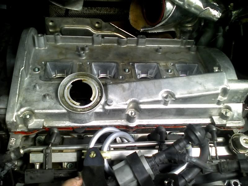

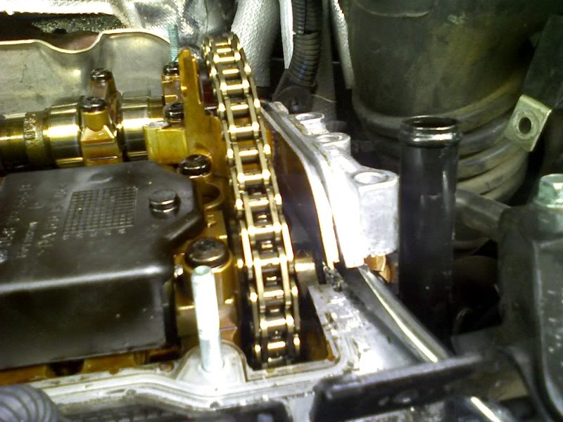

Well I got it done... it didn't fix my vac leak, but my boost levels are higher now. I've got some pics about the journey... and thanks to andrew for the idea on how to replace the gasket without removing cams :-) Once you remove the bolt underneath the valve cover that holds the tensioner in place, you can pry up the tensioner enough to remove the half-moon seal and metal gasket. Took me awhile get the new gasket in place, but the headache saved was well worth it. Here's the pics:
Valve cover after everything is removed:

Valve cover removed:

Inside the valve cover:

The method of gasket removal:
