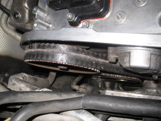

Im going to index the cams as soon as possible. Heres a couple pictures to show you all whats going on. As you can see where the time cover was placed incorrectly it somehow dug into the middle of the belt and its almost split into two. not sure how plastic can cause this but im not surprised.

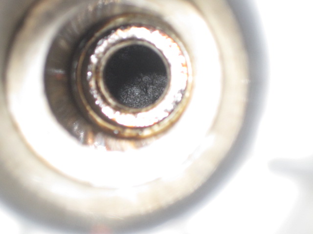

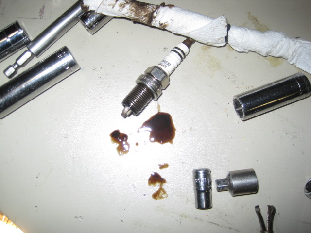

I wanted to check the cylinders, my spark plugs were coated in oil which worries me, looks like the head gasket is leaking. inside the cylinders looks awful from what i see, black residue all around.

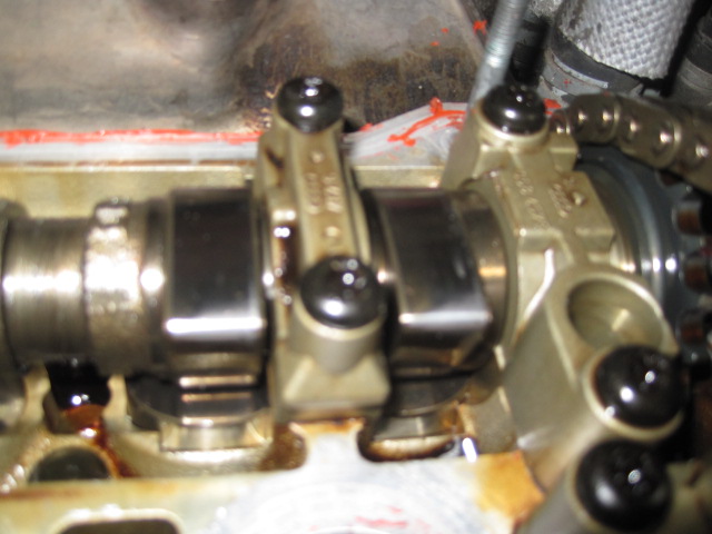

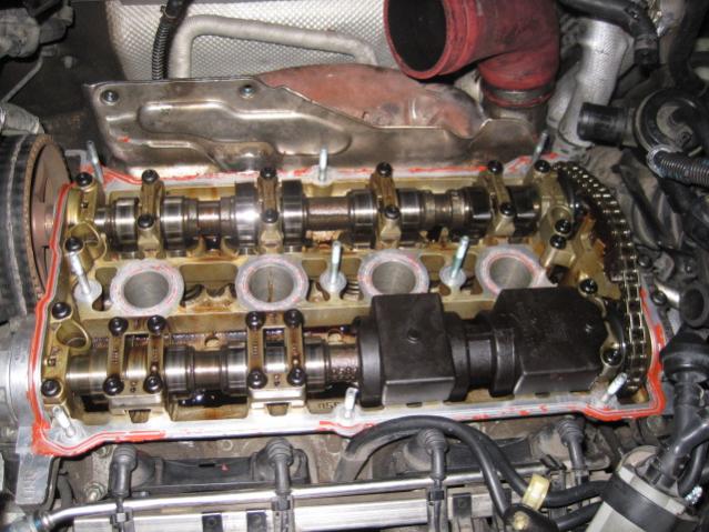

my top VC looks good though. I see no signs of damage, and that was the only piece i ever opened up. workin on the time belt change then see what dreadful thing awaits.
