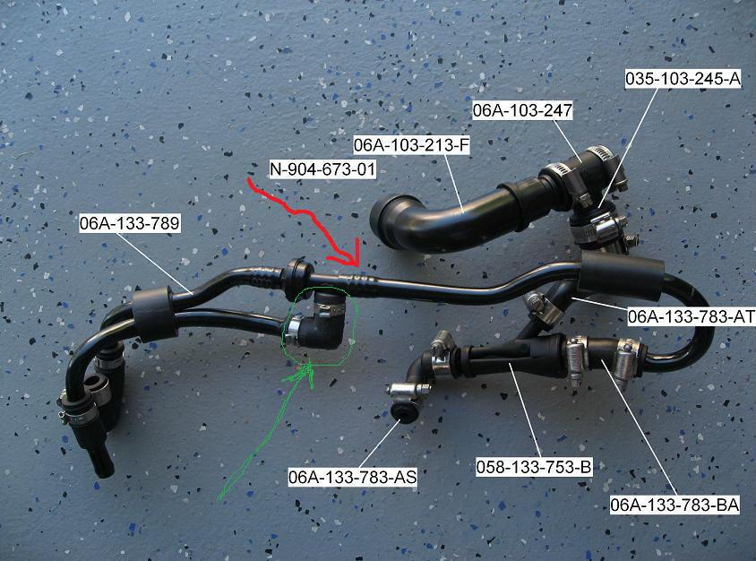

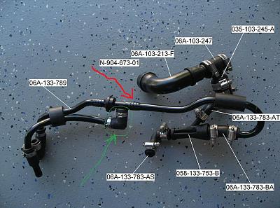

have you got any pics of what I need to clamp?
Actually I have clamped that hose on the photo where is red arrow.
Anyway pressure from electric pump was very low however I have found a leak in vacuum hose - under manifold - challedge to change it now..

thats the hose i was talking about.
changing lines under the manifold isn't too bad once you get that steel bracket off. careful with your dipstick tube (clips to metal bracket), they get brittle over time and break when you do things like, touch them.

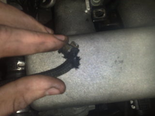

The latest update...I have fixed broken vacuum hose (red arrow on photo)
and also found another broken hose (photo 2)however I is still as same as it was. Have done another logs and pressure is still very very low.
Any idea somebody?
