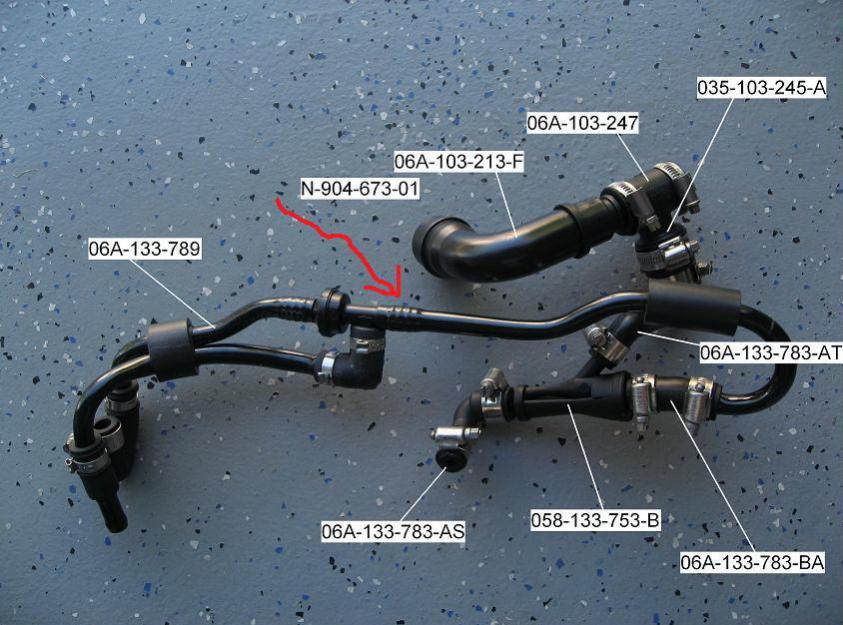

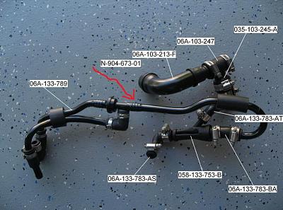

I have found a leak last weak on vacuum hose under manifold - red arrow (as on the picture) - now it is fixed.
Have done another leak test today, first I could only pump 12 psi and could hear an air leaking from hose to manifold - didn't tight it properly before so then I tighten it properly and again pumped 15 psi and no leaks/ air so I assume if I could hear air at 12 psi and couldn't hear it at 15 than I shouldn't have a boost leak......

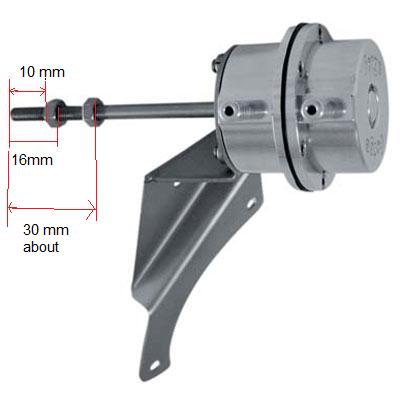

Hi guys,
I just have found out that position of nut on the rod actuator is different on my TT and the other TT with same engine……Another TT has nut from end of rod to outside of the nut 16 mm however I have only 10 mm!!!
Could it cause a problem????
