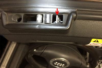

I have this issue as well.
There is a good discussion in another thread on this forum here, with a solution. The link is posted below.
I've attached a picture because it took me a long time to decipher where this switch is. The silver tab becomes bent slightly and a small bend will fix the problem.
https://www.audiforums.com/forum/aud...sensor-109797/
Attached Thumbnails TT roadster convertible roof problem-img_1350-audi-roof-switch-location.jpg
