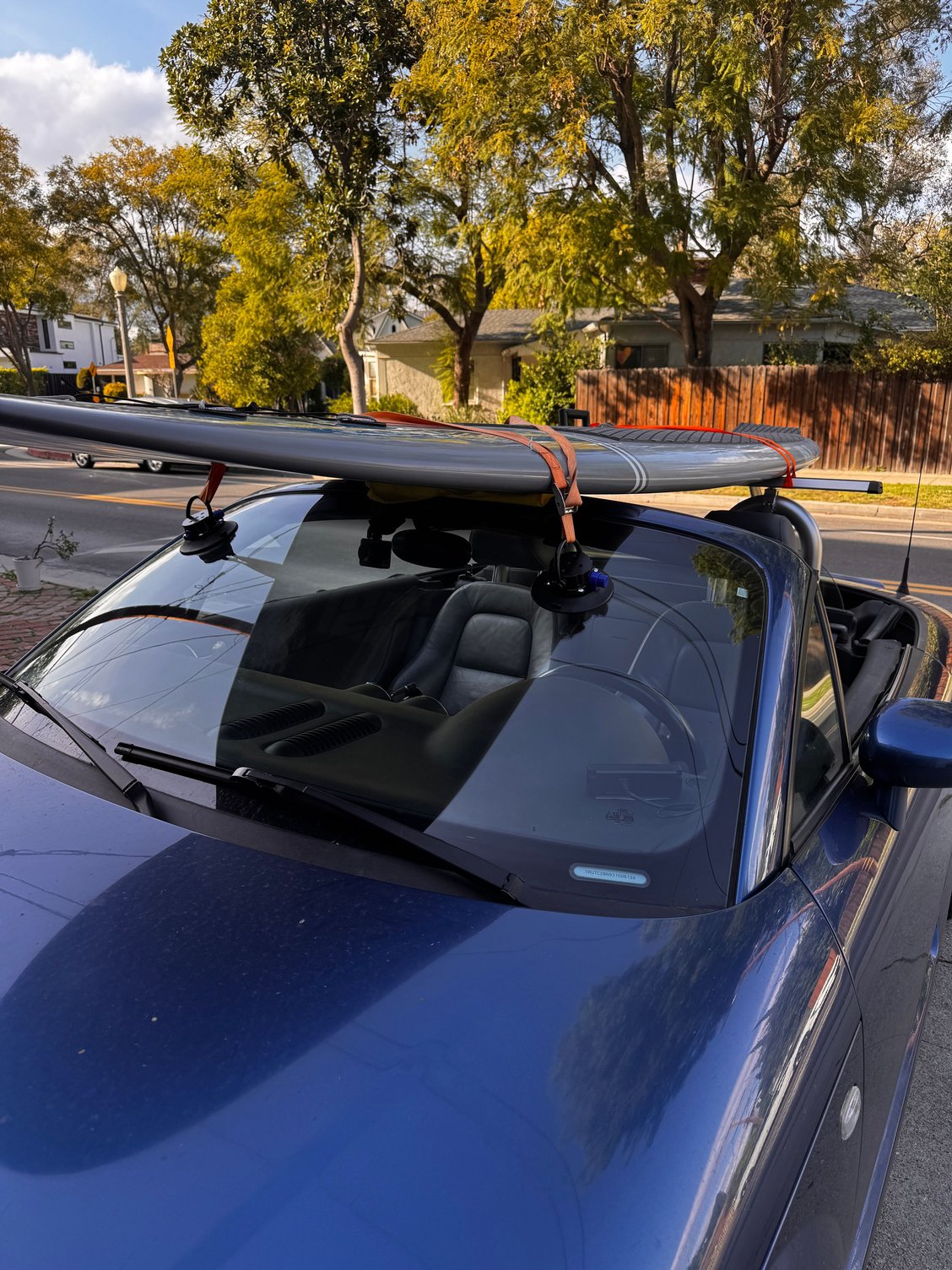

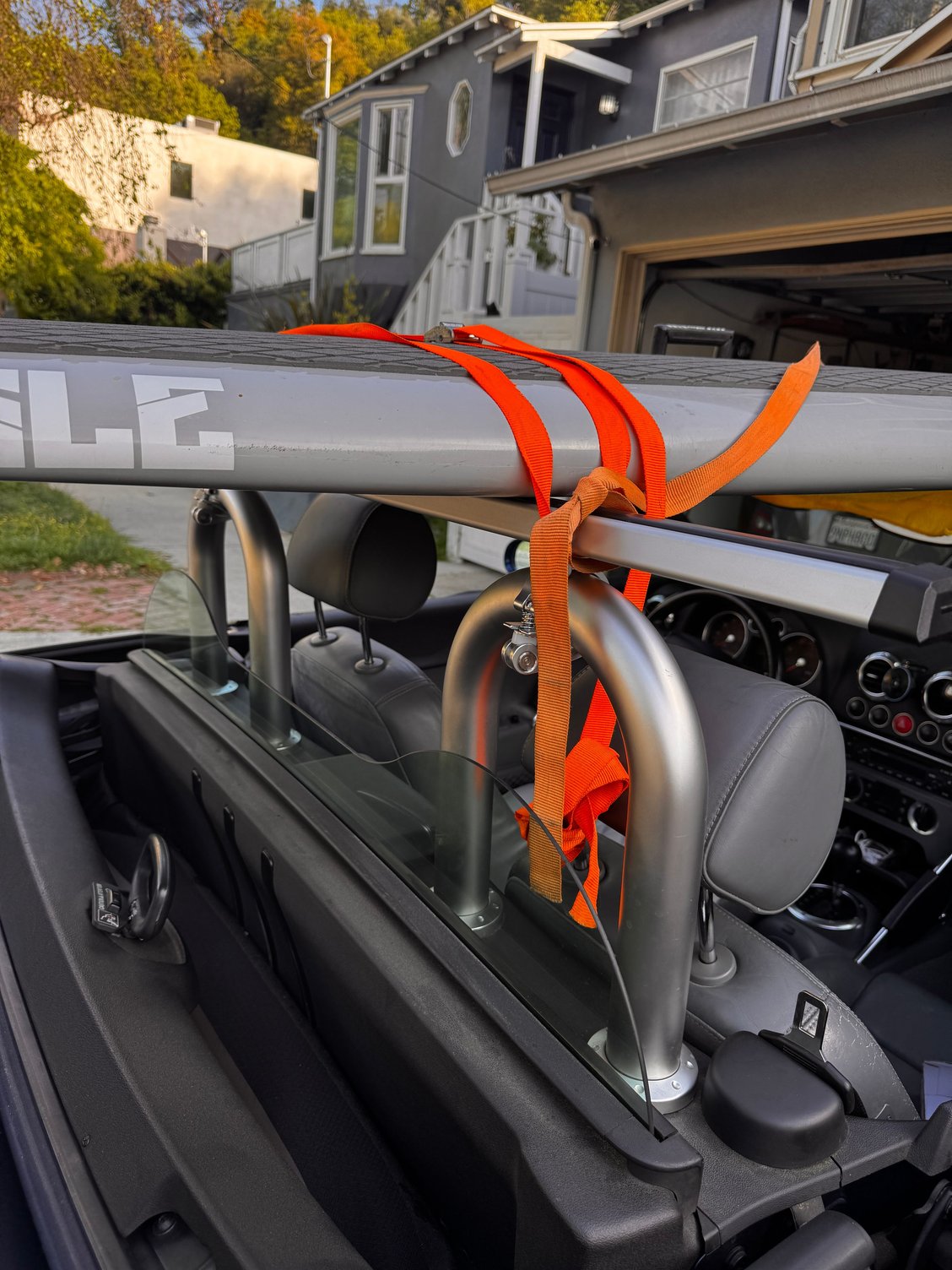

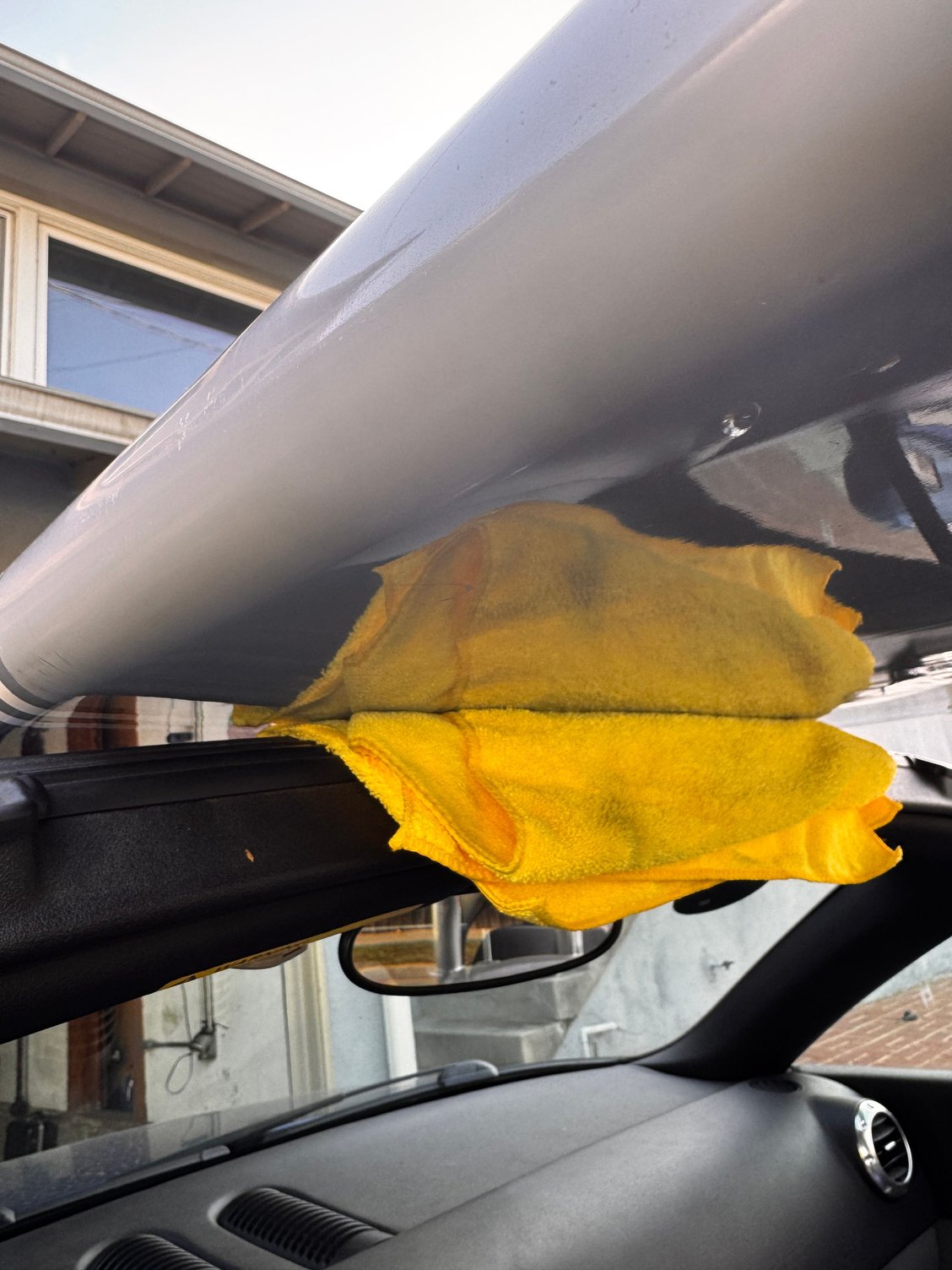

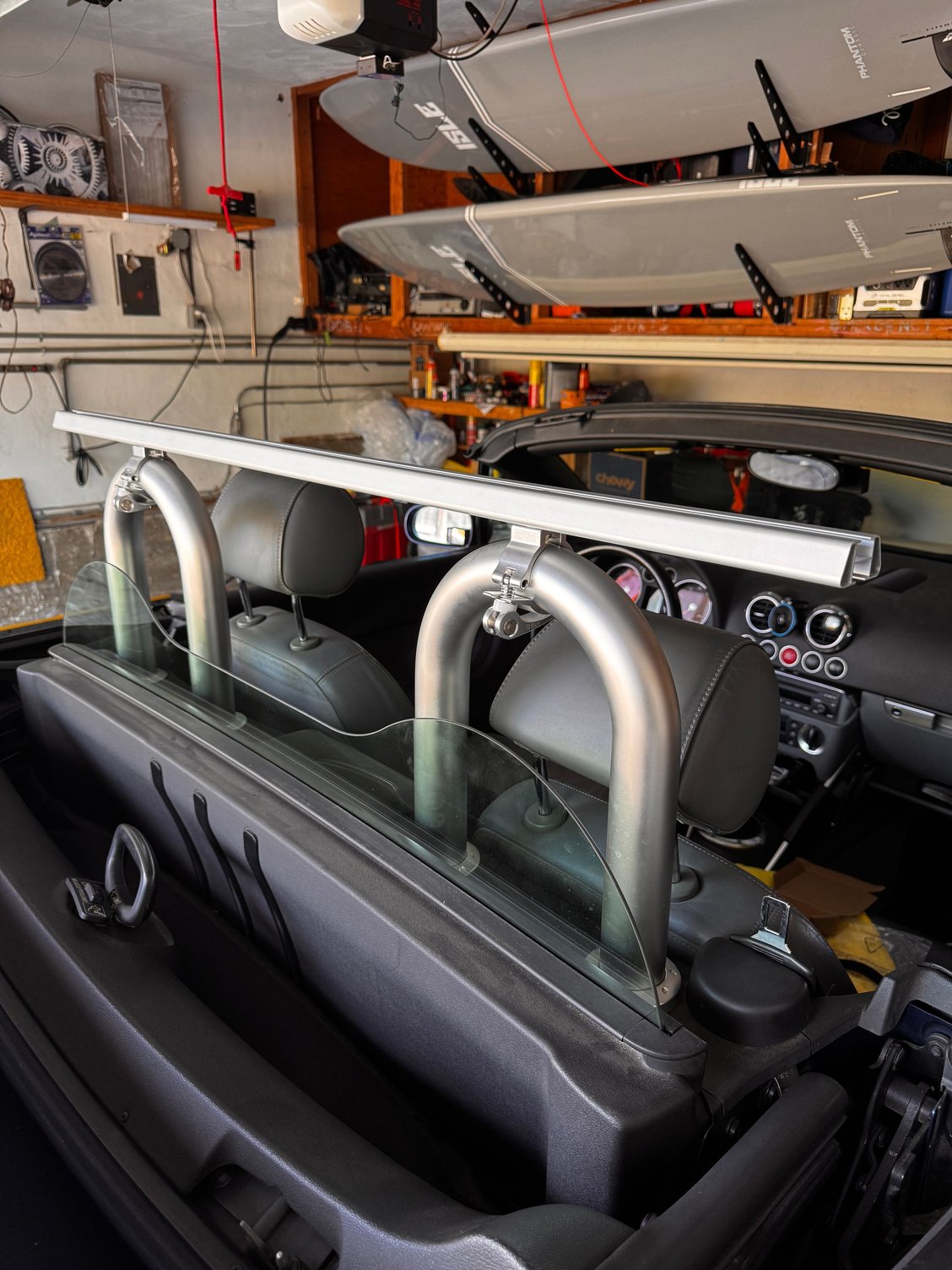

I can now transport my 10 foot Stand Up Paddleboards with my TT!
I got a cheapo universal roof rack cross bar and outfitted it with quick release clamps. The 2nd attachment point are “seasucker” type heavy load suction cups.
Suction Cups on Amazon.
Amazon Amazon
Quick Release Clamps (2”)
Amazon Amazon
