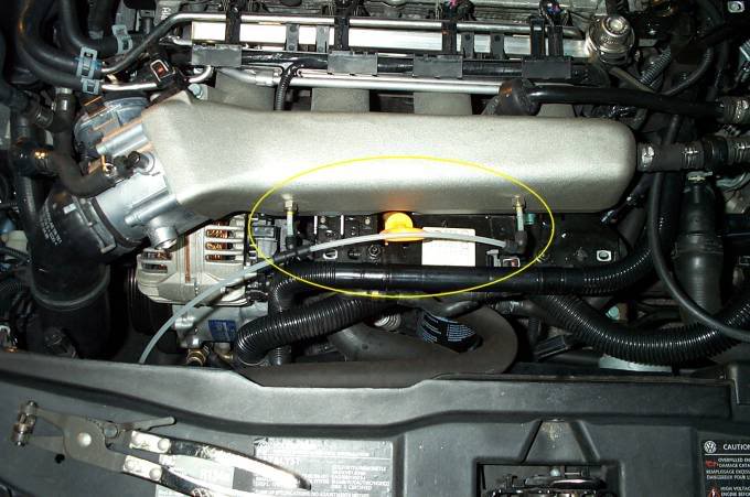

I had bought some smaller nozzles from Snow before I decided to get this kit. I don't know if they are interchangeable (and I plan on only using a single set up), but Chance did say he'd work with me to get the right size if I needed to.
I have run the equivalent of the 5 gph nozzle with my Aquamist kit in the past without a problem. But we'll see. Do you have a recommendation for where to mount the pump?
