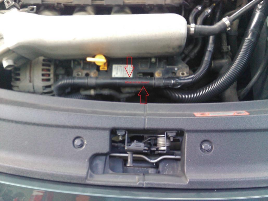

I replaced all the plugs, coil packs, and three vacuum lines. In doing so, I touched this hose, and to my surprise, it broke. I have no idea what it is, so I can't order it. A little help would be greatly appreciated.

what year and make is your car

2000 audi tt quattro
so the 1.8t

Its the hose for the secondary air injection (SAI). You can just get a larger diam hose and connect the broken parts. Its not pressurized so it will be fine. Mine held that way for 2+ years before I got rid of all that crap.
