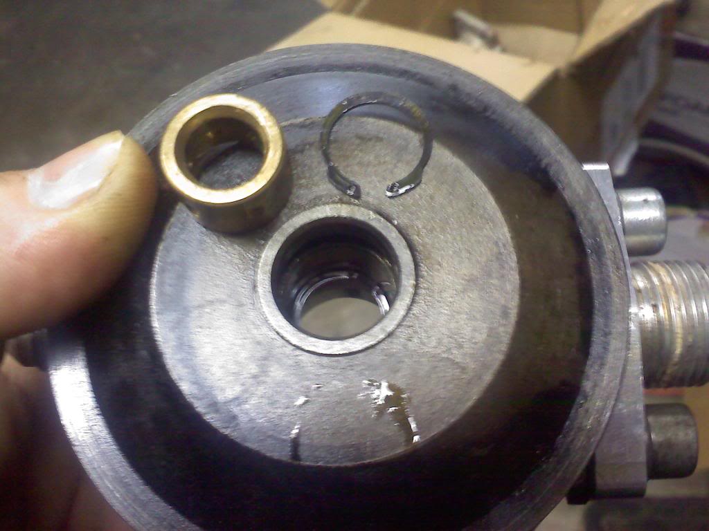

Ok first pic you can see that the turbine bearing is a journal bearing... which from what I've found so far everything says that a gt3076r was a dual ball bearing.

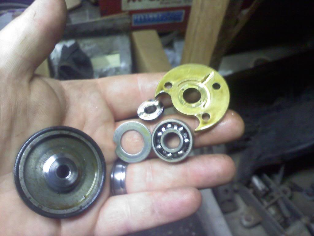

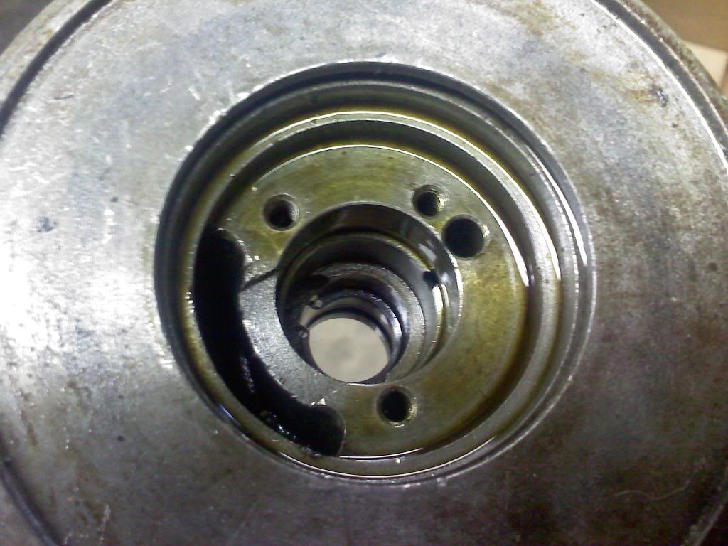

The bearing section on the intake side is a bearing cartridge that is held in with a bolt-on thrust plate, which again from what I've found in searches it says a gt3076r has pressed in bearings that do not require a thrust bearing.
You can see here the bearing cartrage and the thrust plate and the cap that holds everything in. The washer with the notch in it went into the chra before the bearing.

Ok, had gpop shop take a look and they said it's a chineese ball bearing turbo. Not too thrilled about that but at the same time hopeful. I am running a china charger now and it's doing well. I like this one though and would like to run this one because it's bigger and water cooled. So, still, does anyone know if this is rebuildable or at least where to get the thrust bearing. Can I replace the ball bearing with a journal bearing somehow if need be? I mostly want water cooled and rebuildable. So this'll work if someone can help me out.
