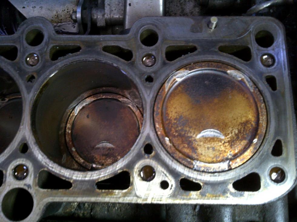

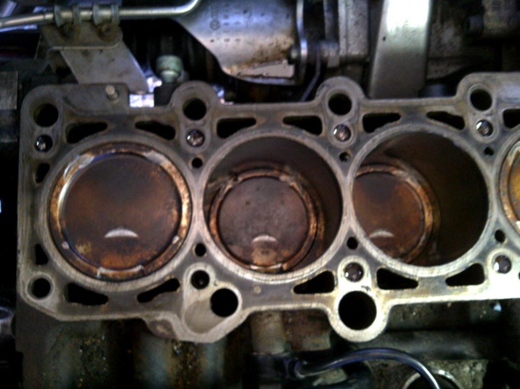

My beloved 02 TT roadster with 150k km on an AMU engine suffered from a broken timing belt. Head now removed, valves bent. Block shows the impact of the interference. (see attached).
What would you do?
a) rebuild old head, $1200+
b) new head $1500+
c) new(er) engine (100k km, for $3,500)
Is the block worth the chance of using again?

Check the cyl walls. If they still seem to be in good shape, just replace the head with a good used one for a few hundred $. You will just need to sand down the valve marks on the pistons before installing the head. If you have the $ for a rebuild (and time), that would be better.

Depending on how much distance there is from the top of the piston to the top ring could be a problem. In the second pic I see heavy damage to the edge of the piston. This may have crushed the piston top down on the top ring. If so, the ring won't be free to move in the ring groove as it should. The problems associated with that won't show up till after you've reassembled the engine and get a few hundred miles on it.
Problems could go as far as broken ring which scores cylinder wall which causes other rings to wear and loose seal resulting in lose of compression and oil consumption.
At the stage you are at, it's not that much more to pull the pan and remove the rods and inspect the damage. At which time you could hone the cylinders, replace rings and possibly pistons, use the old rod bearings if they look ok, or replace them. All this without pulling the block out of the car. If the rod bearings look good then the mains should look even better. You'd be back to, essentially, a fresh motor.
