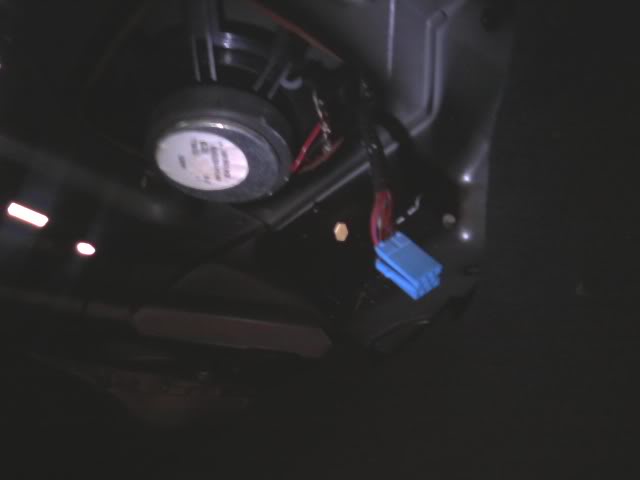

so what did the shop do? could you take a picture of what it looks like? I have a bracket hanging down (silver) with a green and black wire that's disconnected... I'm getting NO noise in the rear deck or in the rear doors with the factory stereo, so im really trying to figure out what exactly is the problem...i was assuming the amp was missing. If anyone had a picture of it, it would really help... I suppose I could take a quick picture of what it looks like now and post.

here is what i am talking about. am i missing something?

Pictured is actually an amplifier, probably using a TI OPA-series or National Semiconductor power op-amp chip. Not going to be very powerful since it'll be driven by the ~13.5 volts of the car. Probably a stereo chip with the outputs in parallel to allow driving a 2-ohm speaker to get a reasonable amount of power out of the low supply voltage.

well as of now im getting NOTHING out of the rear deck speakers and the rear door speakers (once the amp is plugged in )so i am assuming it was the amp went out. is there a fuse up front? where do the green and black wires go?
