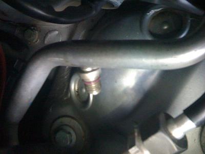

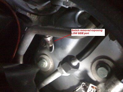

There actually is a LOW side port on the 1996 A4. It is under the low side pressure switch to the LEFT of the battery. You have to remove the switch's electrical connector then use a 17mm wrench to remove the pressure switch. There is a valve behind the switch, so there is NO worry of leakage. You will however need an adapter that screws onto the fitting and converts it to the proper connection. Once you have the proper connection you can start the car and begin to fill the system. When the system is full you must replace the pressure switch and electrical connection.

Yes they sell them all over. It's a very simple procedure, pull off the sensor, screw on the adapter Then use a piece of wire to jumper the pressure switch connector. This will make sure the compressor turns ON while filling the system. I just filled mine a month ago right in the parts store parking lot and its still blowing icey cold air!
