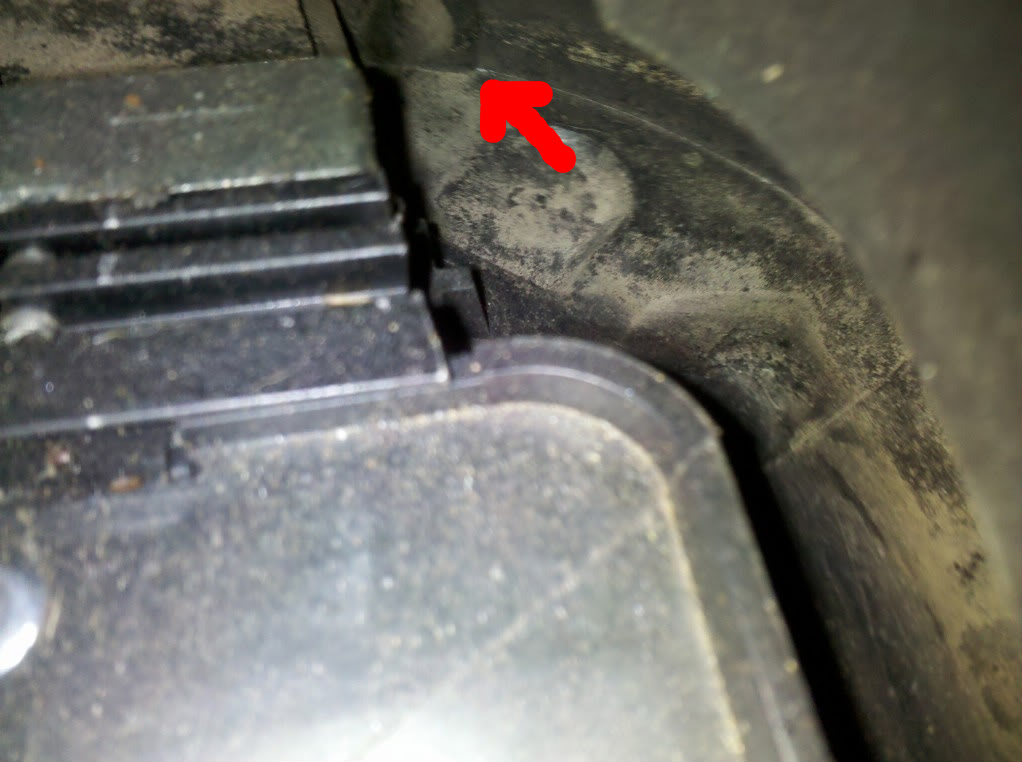

Sorry about the delay, but here ya go. This is kind of a tough pic to figure out, but this is the driver's side front corner of the sunroof. The raised bit to the left side of the picture is the driver's side rail on which the sunroof glass slides. The drain hole is at the end of the arrow. There's a drain like that at each corner.

thanks mate ill have a look , but starting to think like some one posted as mine comes out and up not down and in might not have drain holes but will be checking it out none the less , thanks appreciate it
