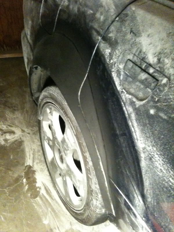

So i added another light coat to this rear fender and it's starting to look wide.....it should be ready soon:
PS: that distinguished line will disappear on the final product so it flows well together

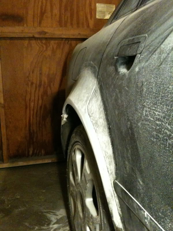

So if you take a quick look at the picture i posted before this, you'll see i came straight down with the flare. tonight i decided i wanted to get something a little closer to an rs4 look so i added the flat edge to my flare.....DEFINITELY a rough draft of the finished look but just an idea of what to expect.

From: Los Angeles, CA
Major props for flat edged flares! I love your project since you don't miss the details that some others do!
