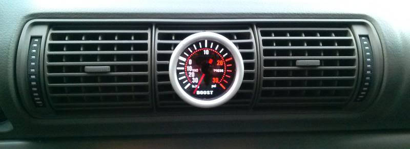

You're not going to hear our turbo spool stock. That's how you know it's working.
+100000 on boost gauge. Just make sure you get an analog gauge, not a "middle-man" gauge (as I call them).
Until then, keep wondering.
Here's what I did:
Keep us posted.

Haha First of all I would like to know what you mean by a middle man gauge. Digital or analog doesn't really matter all that much to me as long as it serves the purpose of showing me her boost/vacuum lol. My biggest problem with the gauge setup up is I don't want to clutter up the dash on top so the vent is the only setup the makes sense to me. $179 on ecs is a bit steep though....

That's why you just cut the vent yourself like all of us have done. It's not very hard I just did it 2 weeks ago. I'd get a vent from the junkyard to practice on first if you're unsure at first how to do it. The gauge I posted comes with everything you need and the reason it is so popular is because it matches the cars very very well.
