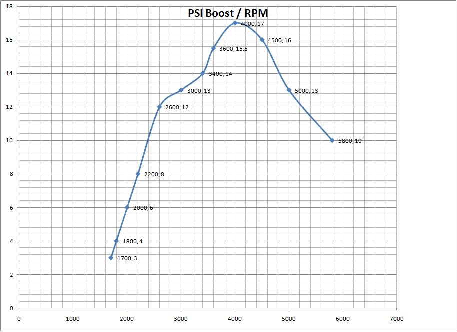

With "TAP Stage 2 - +50HP - 12 psi" chip (still haven't found out what that is, and TAP does not exist anymore?), downpipe and FMIC, I get:
Next, I will try the larger K04 housing (still hoping that it is truly 'bolt on' without the hassle of running new lines), larger turbine (K04 modified), similar compressor with the expectation to extend the high psi (say: 16 psi) all the way to 6000 rpm (but will need more fuel (maybe I can squeeze a bit more out of the stock injectors by cranking the pressure up to 5 bar; but expect lean condition at WOT and high RPM) and thinking GIAC PC16 file).

Agreed TAP is crap from the past, did you see his boost plot lol? And .48's are a waste of time usually, but they wont break rods as easy and spool quicker, they have their place for some things.
