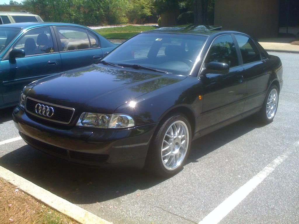

Just wanted to say a quick thanks to the few folks who have documented their A8 front brake upgrade, it came in very handy yesterday as I upgraded my front brakes to the A8 ones. I found the complete kit which consisted of: TT carriers, cross-drilled Zimmy rotors and Mintex pads for almost $400 and also replaced the front brake hoses as mine were completely shot. The write-up was straight-forward and I especially appreciated the part numbers, I used those to shop around and put together the best deal for me.
All in all, every A4 owner that is chipped and runs on bigger than 16" wheels will benefit from improved front brake power.
Couple pics for you guys:
There you go,
You actually have to type out the word "Image"
Also-It looks really good EXP on black cars if you paint the frame around the Grille black. I have pictures just let me know and ill post some. Or just search

Actually, the kit is designed to fit under the OEM 16" wheels, so you only have to upgrade wheels if you have 15". Glad they worked out for you - it's quite a dramatic difference isn't it?

And BTW, to make the pics show up, all you have to do in your link posts is change IMG to img (use lower case and it'll work fine).

Thanks for editing to show the pics, I completely forgot the IMG needs to be lower-case, much appreciated guys.
Thanks also for the kind words and advice. I actually kind of like the brushed aluminum look on the RS4 grill. I did NOT like the shiny (but now old and chipped) stock grill, so it had to go.
Upstate, I meant to say that those with larger wheels than OEM (and therefore most likely heavier than OEM) would do well to upgrade their brakes on the front. A lot of SUV owners that go all-out bling on their wheels (20" or more) soon find out that the brakes don't perform as they once did. The larger the wheel, the farther out the weight goes and stopping it requires more force. Audis in general have great brakes compared to most any other sedan/wagons, VWs included. But when you upgrade power AND add bigger, heavier wheels (not to mention the extra space seen) upgrading brakes to a larger size improves safety and looks, IMO.
That was the No. 1 reason I did mine; plus i used the excuse that my RF brake was dragging in turns and it's not safe. My better half believes safety is top priority, so green light to upgrade. Probably the caliper sliding pins just needed extra lube, but this was so worth it.

Ah gotcha - I see what you mean. And you're definitely right - it's scary to see some of these Escalade EXPs (the Chevy Avalanche version) with 24" wheels and 11.5" rotors/single-piston calipers. You're on the money with your reasoning, and it's a great upgrade for the price since the OEM brakes work pretty well anyhow, and the extra braking force with the A8s makes a real difference. I love mine
