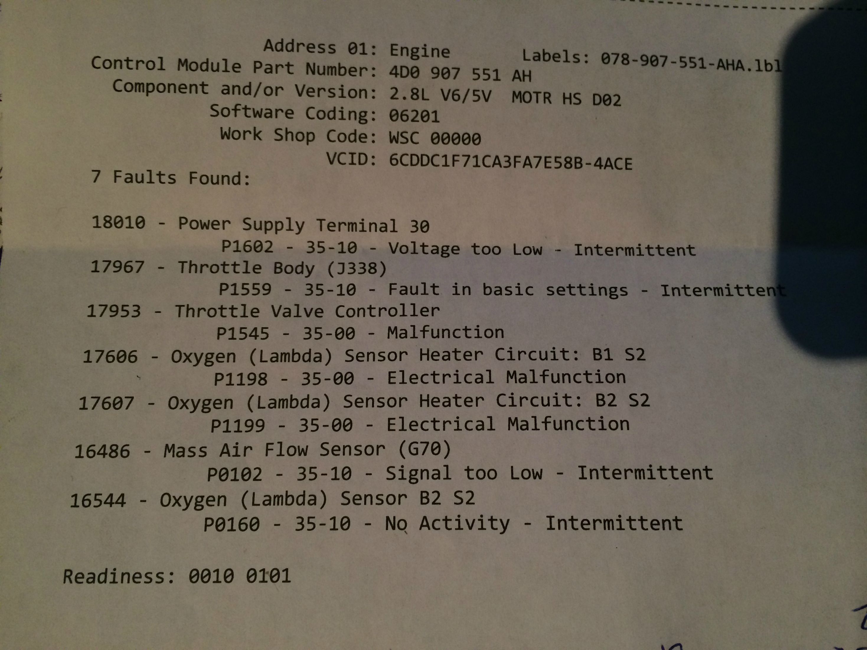

i did vag it and those are the codes i got
the o2's wouldnt have affected the performance so i put in the maf cause it made sense but no diffrence

OK, I think it was the list of codes that started with a 'P' that made us think you had only used an OBD. Go over to Ross-Tech and look up those codes. Their code Wiki is pretty good.
Category:Fault Codes - Ross-Tech Wiki
I'd forget the O2 sensor codes till you get it running right. This is about the throttle body or the MAF, or some huge amount of air leaking into the system post-MAF. But I also find it odd that Terminal 30 voltage is still low at the ECU, even after you've cleared all codes since the battery replacement.
