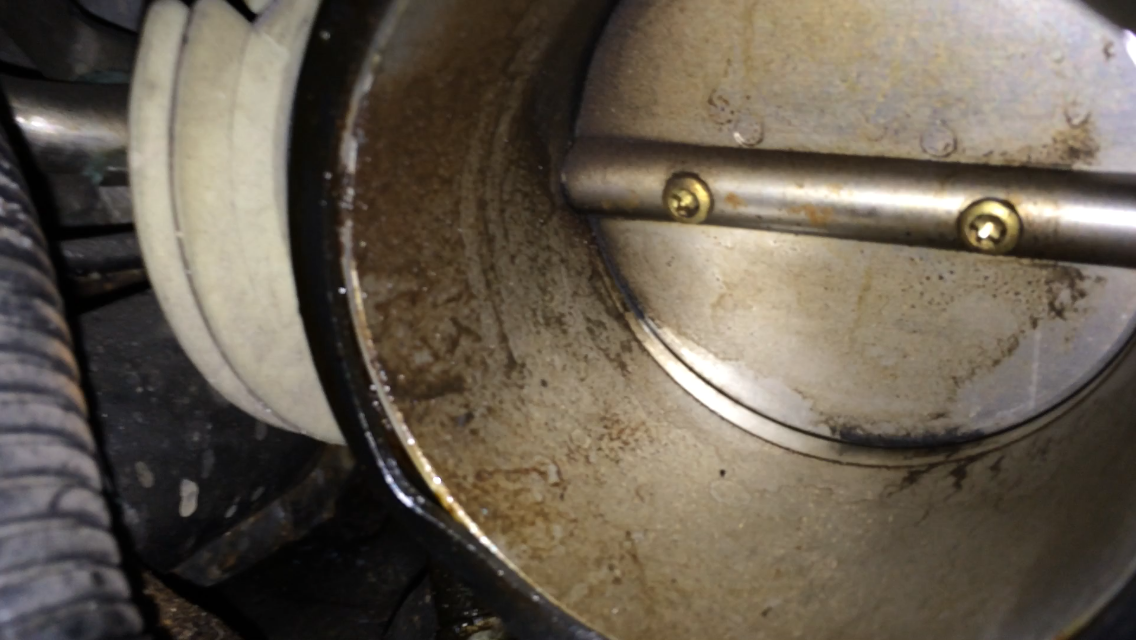

i already put a new maf and air intake in (when i out it the kid took the stock one off and i dont have the stock one) so anyways i finally got to the tb (was a pita cause on the 2.8 there is no room) and its pretty gunked up it got dark out so ill clean and put it back together tomorrow and try and get a guy off kijiji to come to my house with the software to do the realingment for like 20$
