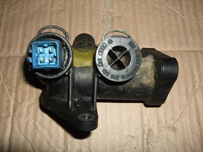

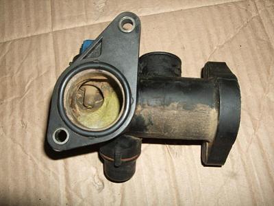

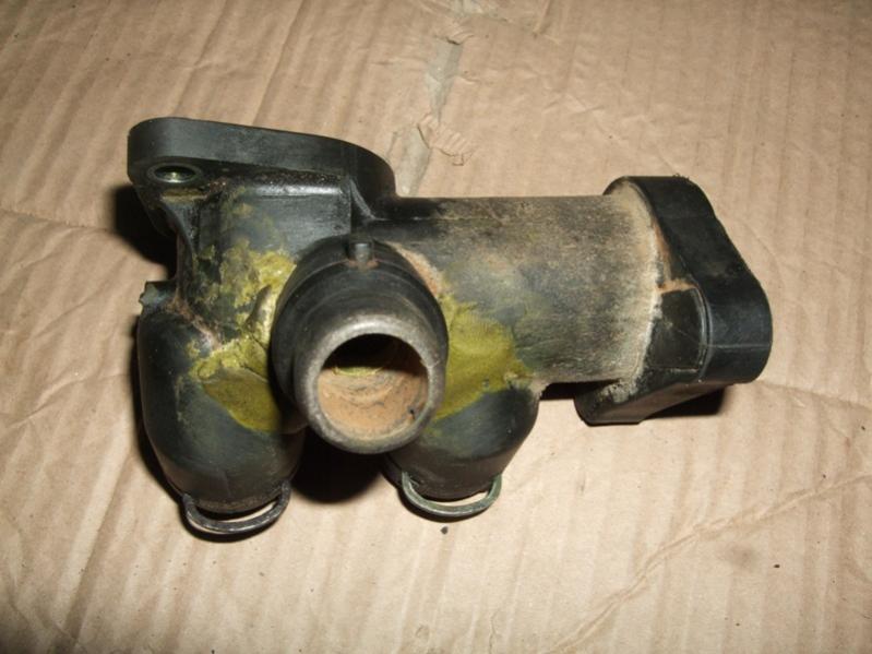

Thanks for the suggestion on the heater core. But I replaced both hoses and the leak persists. I took the car to a guy locally and he determined that it was this unit that has cracked (this is the unit that the 2 hoses lead to). Sadly, he does not supply these parts though and I must source it myself.
The coolant symbol comes on with a beep and oil and engine temps are also above normal after operation for a few km's. (engine > 90)
He tried to stick the unit but was not successful
I looked for heater core on ebay and it does not resemble this unit. I will ask him to check the heater core also.
There is a number on the unit but upon searching, it is the no. for the cooling hose flange plug, not this housing.
I need a part number or any number to locate a replacement part. Please see pics for broken part.

after deeper searching, I determined that the unit is just called the 'cooling hose flange'. On ebay, there are packages with the flange alone or flange + kit (o-ring, clips, plug), which 1 should I buy?
